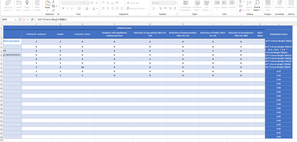

Hi,

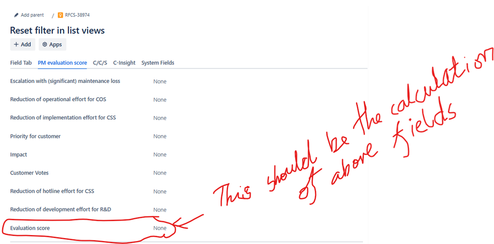

I need your support in creating an automation for calculating the field value from other fields. The tricky part is, I have this formula in an excel sheet, this needs to be transferred to Jira. It works perfectly in Excel, but in Jira, I don't know how to set up this. Please see the screenshots attached and that's the formula which needs to be transferred to Jira.
As you see in the screenshot, I need to calculate the "Evaluation score" from the above 8 fields.
Note: The field values are dynamic for each work items, so the automation should be dependent on the varying values of above 8 fields.
Here are the custom field id's of the fields you see in the screenshot : 12777,12778,12779, 10153, 10154, 10155, 12780, 12781.
Kindly let me know if you need any additional information.

Hi @Amal Johnson
You may do this with three different automation rules:
  1. One triggered on Work Item created
  2. One triggered on Field Value Changed, selecting all of your input fields
  3. One contingency rule, disabled by default.  This rule would use a Scheduled trigger with JQL to identify work items to update, and only be used when Atlassian has an outage that does not trigger rules for the first two cases.
Each rule could use a long-format math expression to calculate the value, and an Edit Work Item action to update the field with the result.  (The inline format math expressions should not be used for your case due to the floating point numbers with decimal values.)

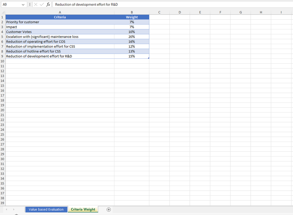

Your calculation uses a table in another spreadsheet tab to help with the Criteria Weights.  I recommend using a Lookup Table for that one to improve maintenance and visibility of the calculation.

Hi @Bill Sheboy , thank you for your suggestion. Do we really need this lookup field here? Because the Criteria weight is always constant for any tasks. Only the field values in the above 8 fields are varying. And also, I dont understand how I incorporate the 3rd rule you have mentioned, could you please help me with that?

No, the Lookup Table is not needed.
It may help because longer math expressions (particularly when duplicated between different rules) can be difficult to maintain...and could easily introduce errors.  When you expect the Criteria Weight values to be very stable and you have good change management of rules, perhaps skip the table.

{{#=}}ROUND(
({{issue.customfield_12777|0}} * 0.07) +
({{issue.customfield_12778|0}} * 0.07) +
({{issue.customfield_12779|0}} * 0.10) +
({{issue.customfield_10153|0}} * 0.20) +
({{issue.customfield_10154|0}} * 0.16) +
({{issue.customfield_10155|0}} * 0.12) +
({{issue.customfield_12780|0}} * 0.13) +
({{issue.customfield_12781|0}} * 0.15)
, 2){{/}}
