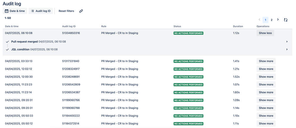

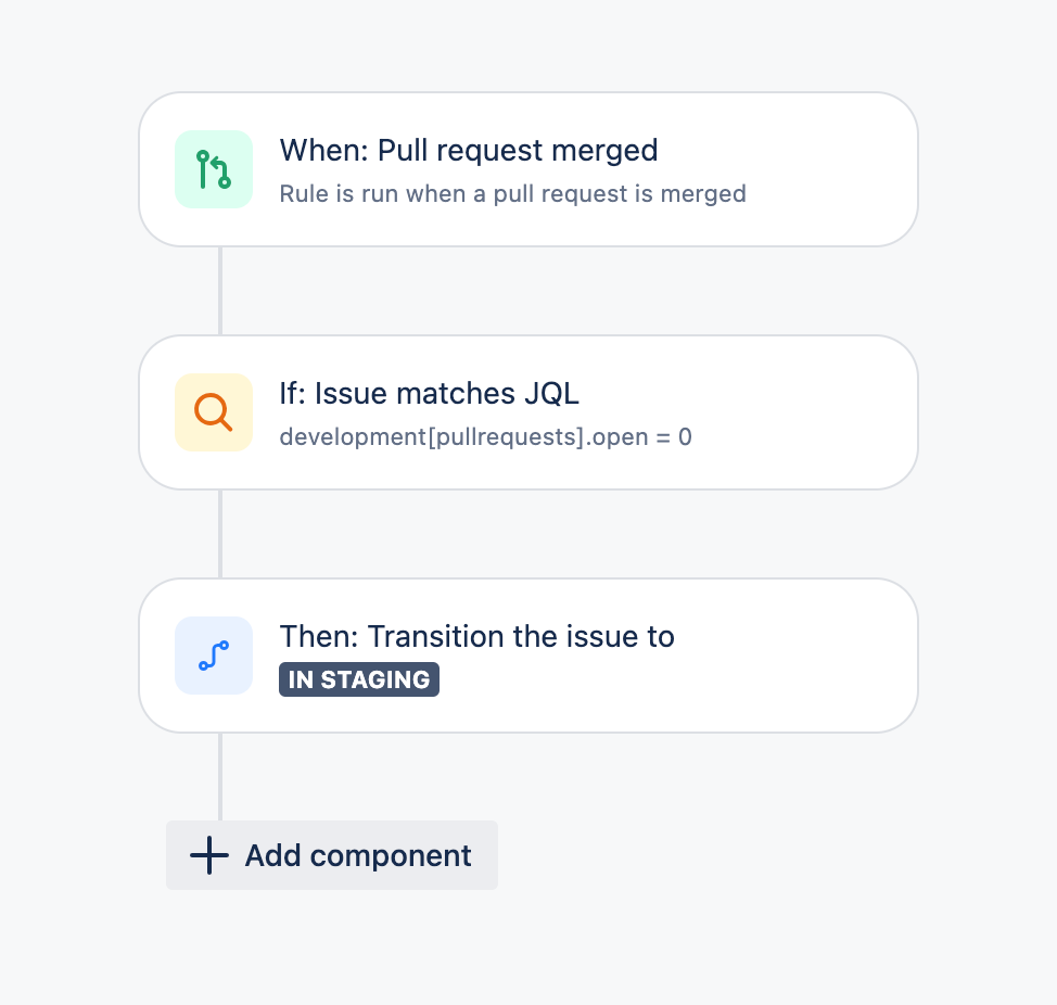

I have the below automation in place to transition an issue to an 'In Staging' status upon a PR being merged. It's been working up until a couple of weeks ago in which nearly all of the items are resulting in No Actions Performed. I've attached a screenshot of our audit log as well.

Hello @Kelsey Wilson

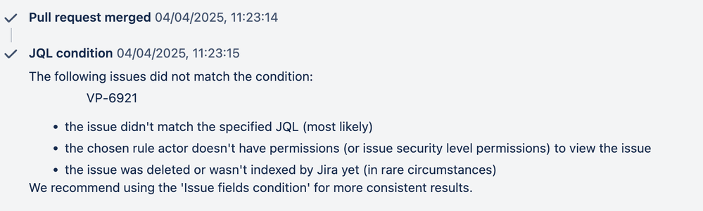

In the Audit Log entry on the right notice the ">" characters. Click on each of those, and if more display click on all of them. That will reveal more details about the log entries.
Without all the details it is difficult to discern the root cause.

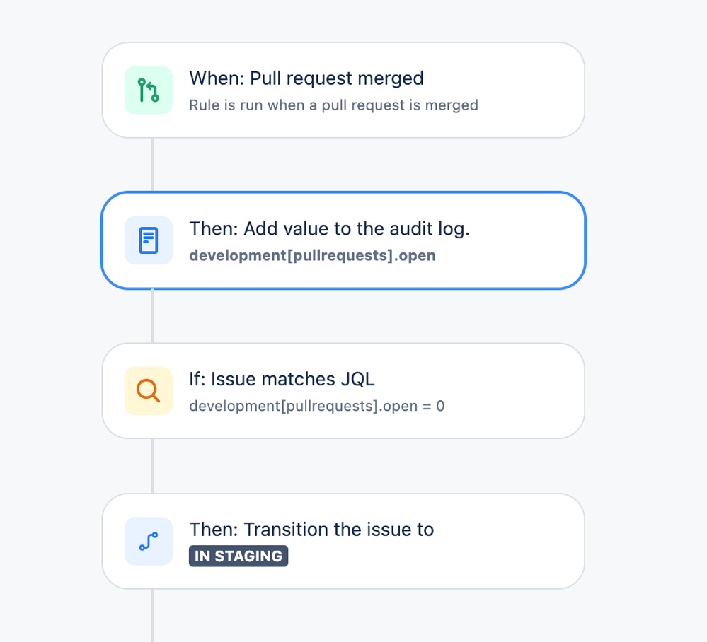

Can you add a Log action before the condition to write the value of development[pullrequests].open into the audit log?
@Trudy P Claspill Can you please confirm exactly what the log message should be?
In the Log Action put into the entry field the exact smart value you are using on the left side of the comparison.
You need to cause the rule to execute again for an issue that you believe has no open PR's. Then look at the log and see what appears in the Audit Log for that Log Action.

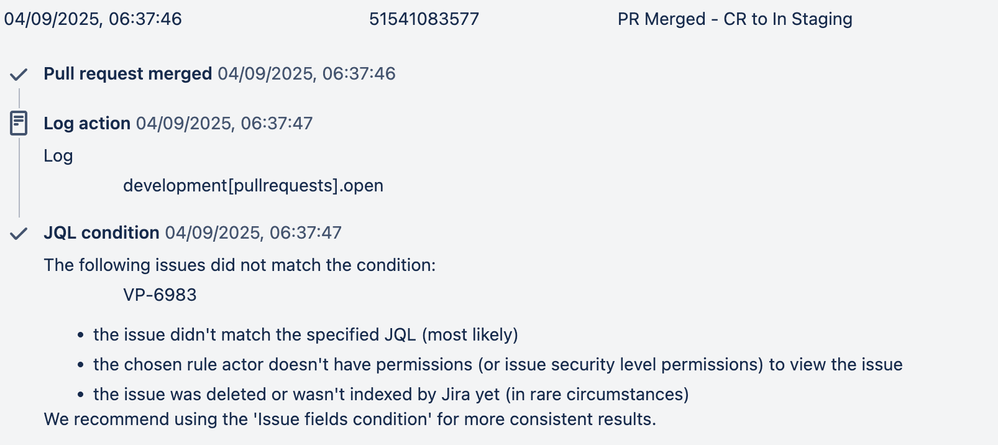

@Trudy P Claspill This is the result of the latest execution (on a ticket I know for sure has only one PR and it's been merged)
I apologize. I thought it would be a simple matter to print the number of open pull requests but based on my additional research it does not appear to be a simple matter. Go ahead and remove that Log action.
Since the rule is saying the issue doesn't match the JQL I was trying to ascertain what the value of development[pullrequests].open was at that moment.

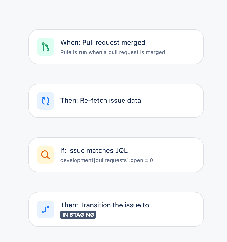

If the result is that the issue is listed, then there might be a timing issues occurring in your rule where the rule is triggered and the condition is evaluated before the system is fully updated.
In that case I would recommend that before the condition you add a Re-fetch issue data action.
https://support.atlassian.com/cloud-automation/docs/jira-automation-actions/#Re-fetch-issue-data
@Trudy P Claspill Confirming that the result of the JQL you shared is the issue listed. Additionally, I added the action to re-fetch issue data before the condition and I am still not having any success transitioning my issue. Please advise.
