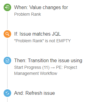

I have created an Automation for Jira (3.9.4) rule to transition an issue when a field value changes that matches a JQL condition. This rule works behind the scenes, but the status does not update visually in the issue unless I refresh the issue or page. I have tried adding a Refresh issue Action at the end of my rule, but that still doesn't correct this problem. I am running a trial on Automation for Jira right now and I would really like to know how to fix this before I spend any money. I am using this on Jira Core Server 7.6.2. So, is this a Jira or Automation problem?

Yes, the transition is visible on the transition tab. Jira knows whats up because when I try to manually transition, I get an error that says the task has already been done and I need to refresh the page. I was expecting Automation to change the Status from Not Ranked to In Progress, but it doesn't do it on its own. I am not sure about your comment about the right tool, it seems that the rule looks exactly like I would expect, but I am not in the software industry... I am in the business sector... so I do not know what you mean by a webservice and listener. Are you saying that the rule below will not work?

You cannot perform 2 transitions with 1 action. If the value of Problem Rank is changing as a result of a transition than this rules will not work.
Have you tried changing the Problem Rank using the edit dialog on the issue screen?
Todd Palermo
February 8, 2018
I think I am doing it as you suggest.
I may not have explained the scenario correctly. A problem is created and is in the first status "Not Ranked".  When the user edits the problem field "Problem Rank", then this rule sees that the value has changed from empty to not empty. Then the transition is changed to Start Progress. This happens, but the screen doesn't display "In Progress", however, Jira knows that it is "In Progress" because when I try to manually change status with the transition button, I get an error telling me that I can't move to "In Progress" because I am already "In Progress". I may need tech support from the developers. This seems to be a bug on their end.

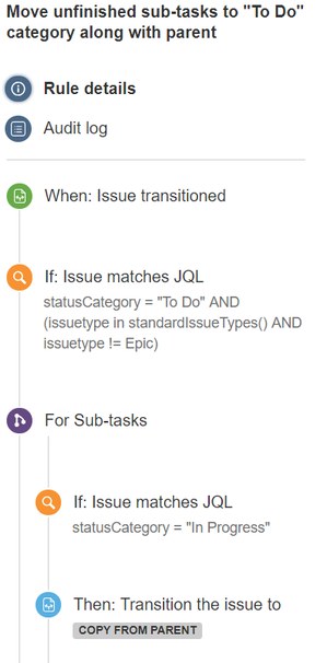

On Kanban board & backlog I want basically all sub-tasks to follow parent task in certain conditions
If someone moves a story/bug/task from one of the statuses, that fall into statusCategory = "In Progress" to "To Do", I want all unfinished sub-tasks to follow.
As I intend to have it as global rule:

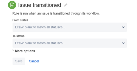

The workflow and 2 relevant transitions I use for test:
KanBan board config:
STEPS:
Enable as global rule
On test project have a story with sub-tasks, at least 1 is DONE
Kanban board: Move story + some of sub-tasks to the in-progress (manually, drag & drop)
Kanban board: Move story ONLY to the 'Selected for development'  (drag & drop)
Expected: sub-tasks are moved along with parent
Result;
sub-tasks statuses do change, however visually they're on the same place in board.

So - what do I do wrong or is there a bug somewhere? And if bug - where to report?
It looks to me like in response to automation rule some action on front-end isn't triggered. Is it possible to somehow force the view to refresh?
