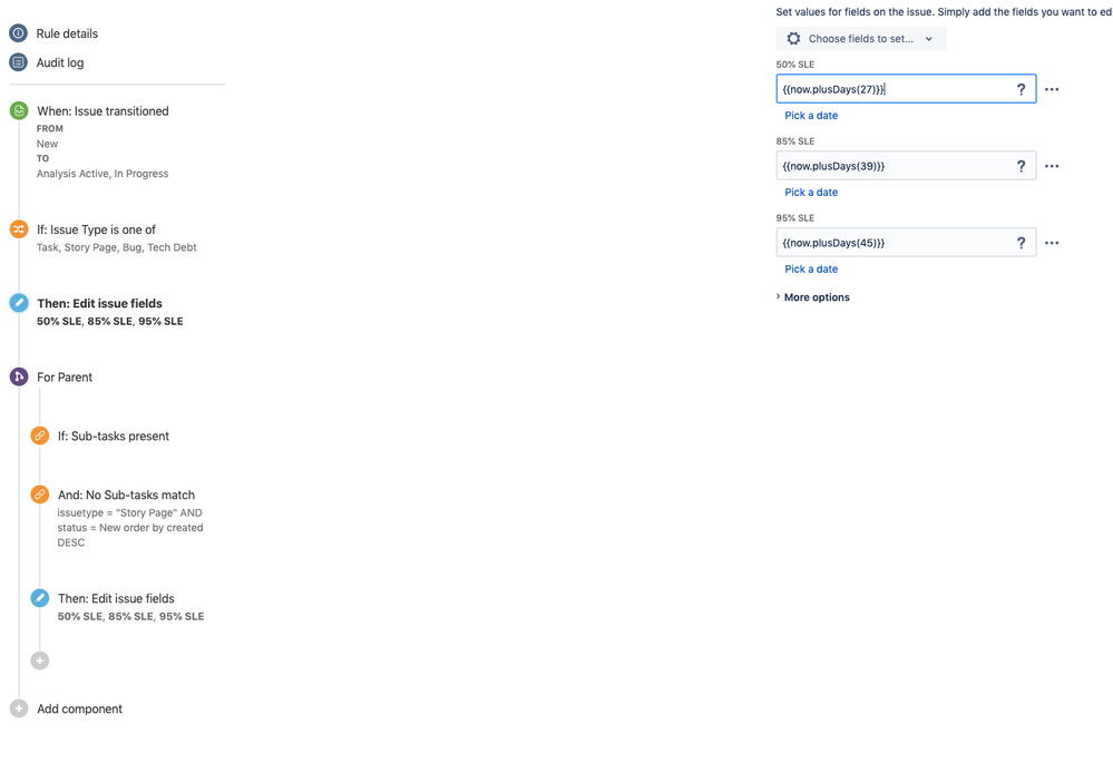

Jack Arndt
January 29, 2020
Thanks for the help everyone!
You helped me solve it :) Here's what I ended up building:

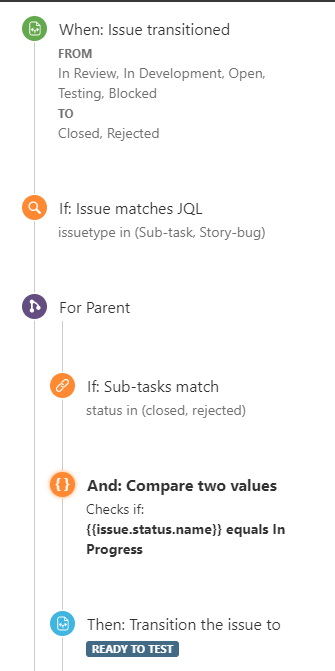

  1. Create a rule that is triggered when issues are transitioned
  2. Filter the statuses based on what you need. i.e., transition parent when all sub-tasks are closed.
  3. Filter the issues you want the rule to work for, i.e., for sub-tasks only.
  4. Create a branch for parent issue
  5. then use a related issue condition and for the related issue, you can have a condition 'all match specified JQL' and the JQL will be status in (done/closed whatever you use).
  6. then use advanced compare condition to validate if the parent issue is in the correct status to transition from
  7. then transition the issue to your desired status
  8. and add an edit rule to use on your custom field with the variable {{now}}. You'll have to create the custom field in Jira and define it as a date type field.
Here's an example of the above rule that can be modified to your needs:
