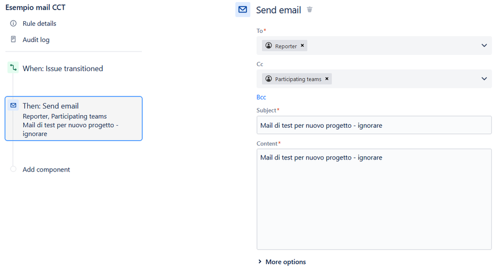

I've been playing around, and accidentally discovered that group picker fields are recognized if you write the full name, the same way you add groups:
We can work with automation for mail notification.
Thanks John, your tip guided me the toward the solution!
