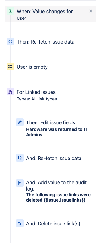

In project A I want to trigger the automation
(Field "User" is changed)
Then check if the "User" was set to "empty"
then I want to take a look at the issues that are linked to the one in project A, which are in project B.
Then I want to go into the ticket of project B and change a field value (hardware returned to IT Admins -> yes) and delete the link between the two issues and write the links in the log.

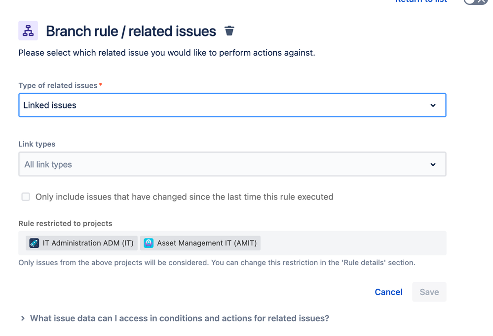

My current state is this, my audit logs recognizes the right issue from project A that I am testing with but does not find the linked issues:
Branch rule / related issues
No related issues could be found.

Hi @Solveig Petersen, it should work. Did you set the scope to multiple projects and selected projects A and B? What did your Automation rule audit log say? I'd remove the second re-fetch issue data; I don't think you need that.

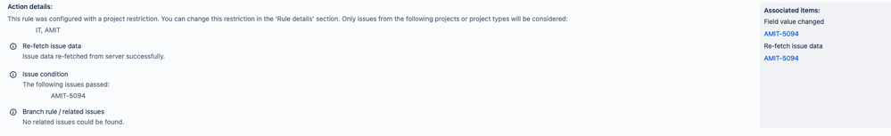

Yes I did put the scope to multiple. The audit log said all worked fine except
So I believe it does not find the linked issues?

I recreated the same scenario, different fields, though I got it working. You actually should be seeing more steps being logged on your Automation audit log. Try isolating the steps by changing things here and there, so you can make sure you're going through each of the steps. Also, I'm assuming the project permissions are aligned with the actions you're trying to achieve. Look at my setup; let me know if you spot the differences besides the fields, which shouldn't matter much.
Screen Shot 2021-09-07 at 1.15.21 PM.png Screen Shot 2021-09-07 at 1.19.32 PM.png

Also, check if the branched rule is restricted to the projects in scope.

The branch rule includes both projects that this rule should act in.
