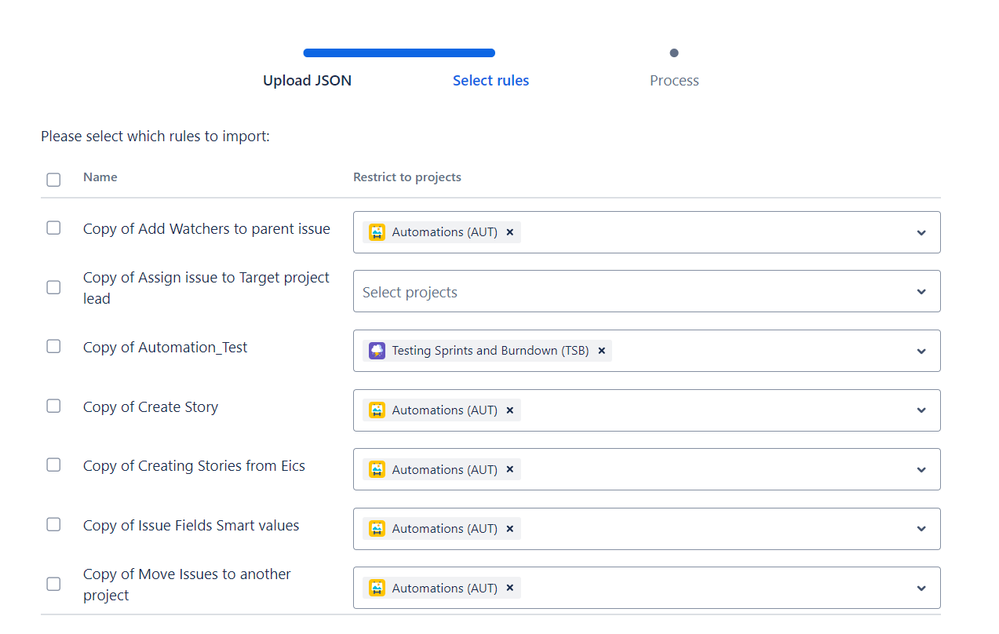

Have you tried to choose when you import? You should get a screen like in the screenshot. You should be able to choose the rules you need to import here.Automation Rules Import.png

@Anandhi Arumugam _Cprime_
It restricted me at the first level when fetching the JSON file. Once that is success then only I could see that page which you mentioned in the screenshot.
