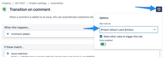

Jack Brickey
August 12, 2020
ok so with the original JSD Automation you can change the run rule as the rule level by clicking on the cog.
Note: the user that is set to run the rule MUST have permissions in the project where the action is being performed.
Rosana Casilli
August 12, 2020
Thank you Jack!!! I didn't see that icon!!
So in this case the user should be part of the groups that restrict the transitions right?
Jack Brickey
August 12, 2020
Correct
Rosana Casilli
August 12, 2020
Thank you so much jack!! I have just checked that and it works!!
