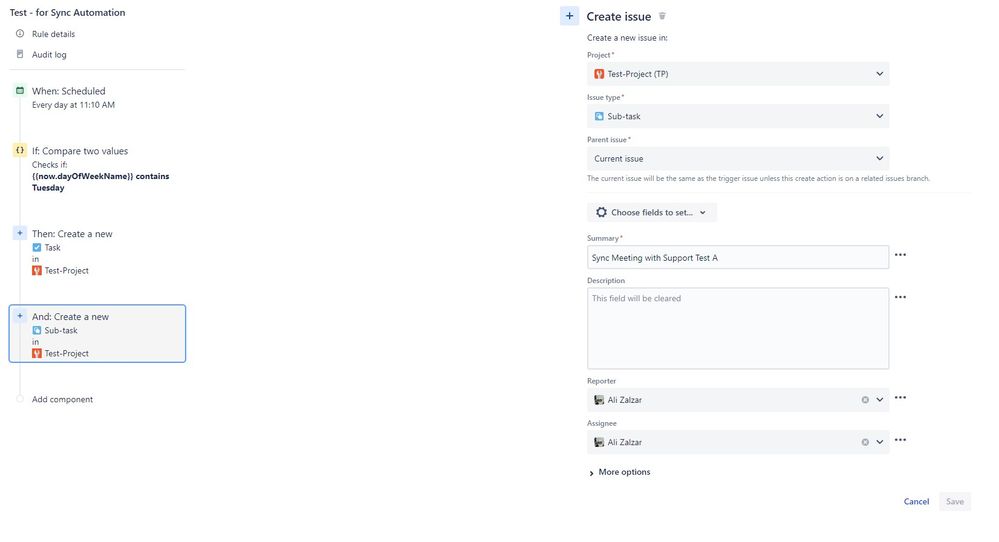

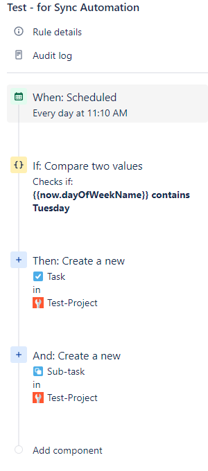

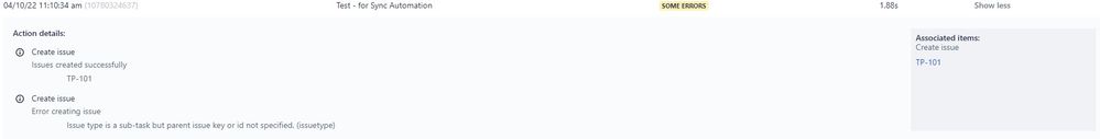

I've been trying to create a Task with 3 Sub-Task through Automation but I keep getting the following error:

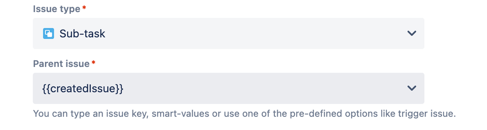

No, you need to write it manually to the Parent issue field. Check the screenshot I attached :)
@Martin Bayer [MoroSystems, s.r.o.]thank you for this answer, but I'm getting the same error, and when I attempt to enter {{createdIssue}} in the parent-issue drop-down, it reverts to "Current Issue" (no more free-text entry).
Jira doesn't seem to like {{createdIssue}} or {{createdIssue.key}} in the additional field JSON.
Any pointers most appreciated - thank you.
The problem is your choice of "current issue" in the sub-task settings.
There is no current issue in a scheduled task, you need to tell the automation which issue you want to create the sub-task(s) in.
