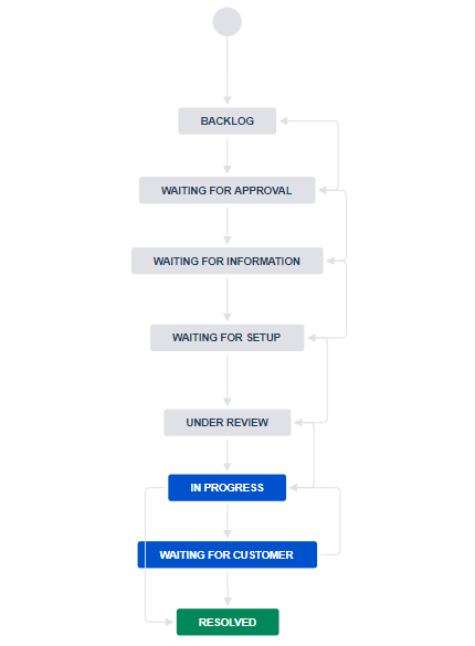

I'm trying to make an email to trigger when an Issue is moved from status "BACKLOG" to "WAITING FOR APPROVAL".
Workflow:
2021-02-11 12_46_15-Edit — Software Simplified Workflow for Project OB1 - Jira.png

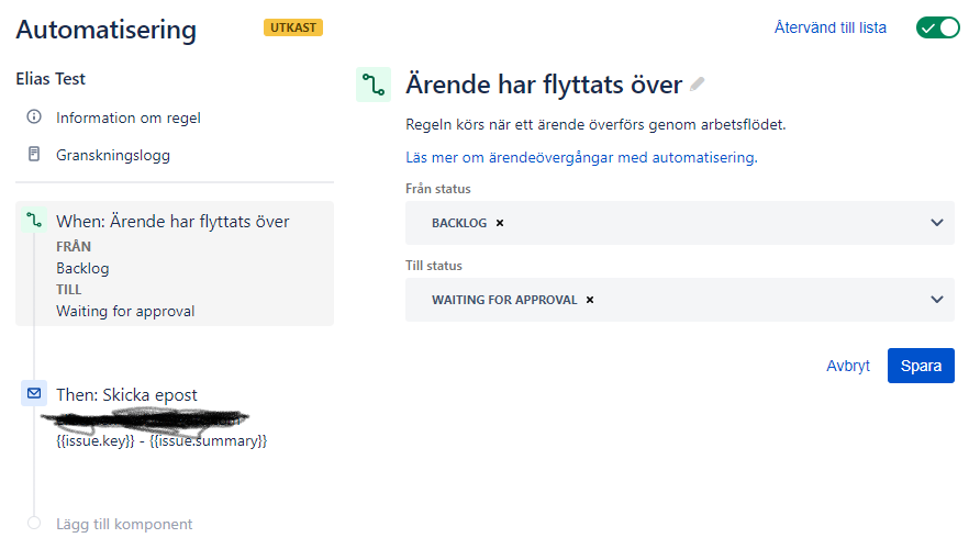

My rule in Automation:
When: Issue has been moved From status "Backlog" To Status "Waiting for approval"
Then: Send email
2021-02-11 12_48_02-Project automation - Jira.pngWhen i check the auditlog i can't see that anything triggers when i move a ticket in the kanban board. Not even an error message.
If i don't define the status From-To and leave it blank it works, but that's not an option in this case.

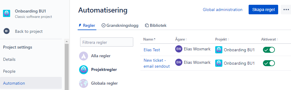

Please check the scope of your automation rule, whether is set to the correct project.
Rule details (Information om regel) -> Scope
If you want to do this on one project, there should be Single project option and under it in Projects field your project selected.
Hana Kučerová

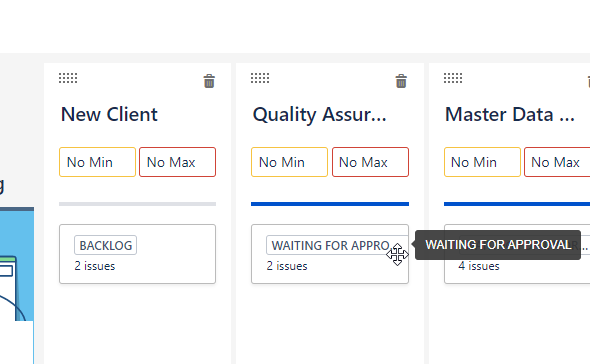

Also please check the configuration of your kanban board, whether the columns of the board correspond with your statuses (so you are really performing the correct transition).

Yes, the scope is set to the actual project and the Kanban board have the statuses in each column.2021-02-11 13_26_33-OB1 board - Project automation - Jira.png
