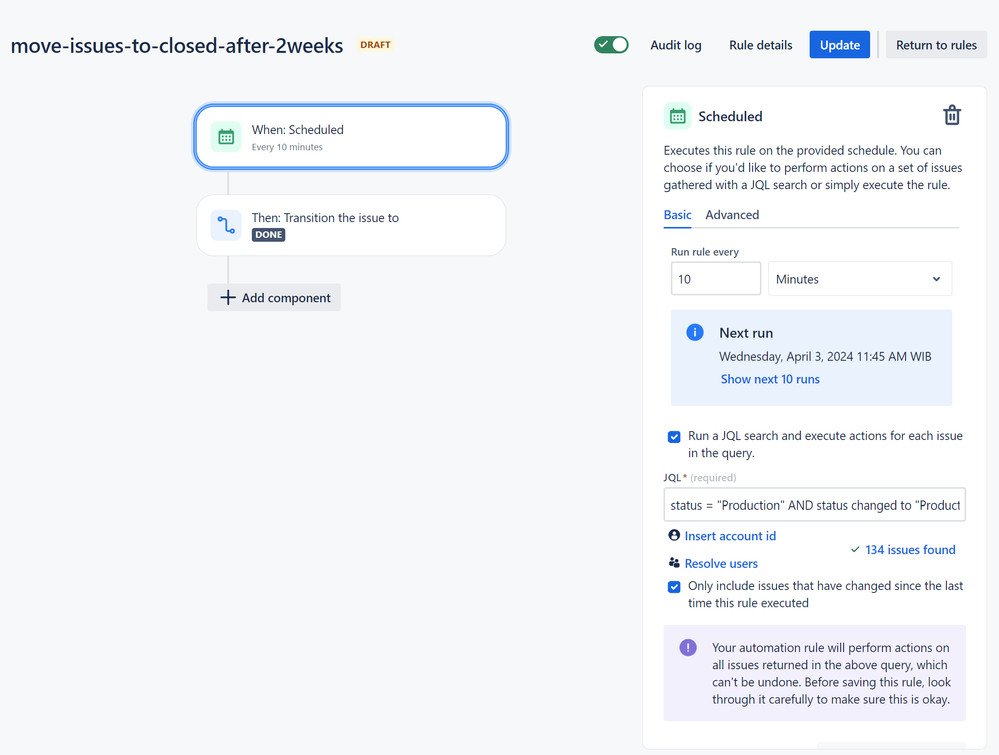

Hi everyone, I have an issue about the automation for Jira Software.
I have read similar case like the link below:
https://community.atlassian.com/t5/Jira-Software-questions/Why-are-no-actions-being-performed-when-my-JQL-finds-issues-when/qaq-p/2431706
But I still have no idea why my automation did not working as required.
Here are some screenshot to help checking the situation:
1. This is the rule for the automation
I tried to run this automation every 10 minutes.
The JQL query that I run is:
status = "Production" AND status changed to "Production" BEFORE -2w
as per my understanding and explanation from ChatGPT, this query should be showing all of the issues that in the Production column and move to the Production column after 2 weeks.
and as you guys can see, when I validate the JQL query, it showing 134 issues found, I also tried in the filter functionality and see the same result.

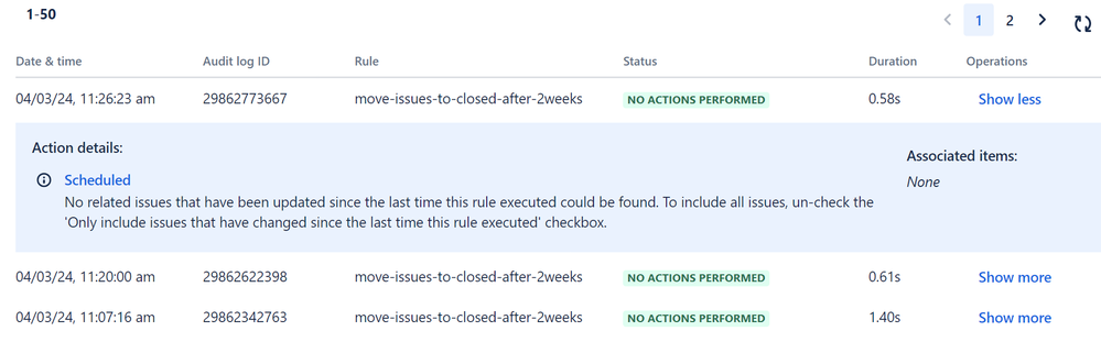

2. This is the audit log for that automation
The audit log showing there is no action performed, I don't know why.

Hi @Dewa Fakha Shiva,
The problem is exactly what the message in the audit log says: you have selected the  checkbox just below your query to
Since you are trying to close issues that have not been changed for 2 weeks, none of your 134 issues have been updated recently. So uncheck this box and your rule should run.
On a small side note about the filter itself: this query does not show all the issues that moved to the Production column after 2 weeks, but the ones that were moved more than 2 weeks ago. That may just be a typo, as I believe this is indeed what you want, but just making sure ...
Hope this helps!

Geethanjali Katagani
April 2, 2024
Hi @Dewa Fakha Shiva ,
I hope this email finds you well. I noticed that you have selected the checkbox in the schedule. However, when the checkbox is selected, it triggers automation to run only once for filtering issues. Therefore, I recommend unchecking the box.
