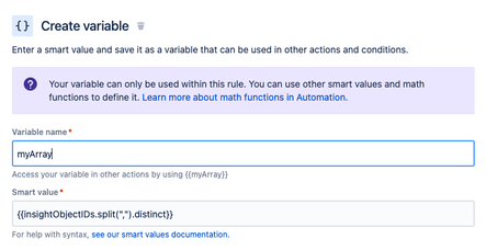

ok, I figured out how you can do this...
Take your result variable, and split it by commas with the distinct function...
insightObjectIDs.split(",").distinct
Then you can use the replace method to get it back to the pipe separator.

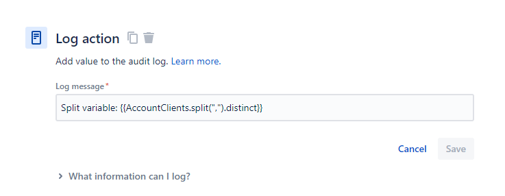

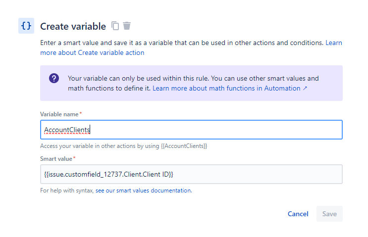

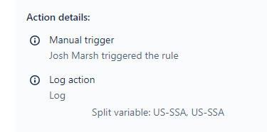

This is a great suggestion but it isn't working for me :( anyone know what I'm doing wrong?
customfield_12737 is a multi-select Assets field.image.pngimage.pngimage.png

EDIT: I just find solution to my problem:
I was using .split(",") before and couldn't solve my problem.
Now I've tried with .split(", ") --> one blankspace after comma.
I suggest making a log-print of a text that you want to split, one step before splitting it. Then make sure there is ", " (comma with one blank space) between each of your values you want to split.
Now, use .split(", ").distinct against your variable, and you should get values as a list and without duplicates.
