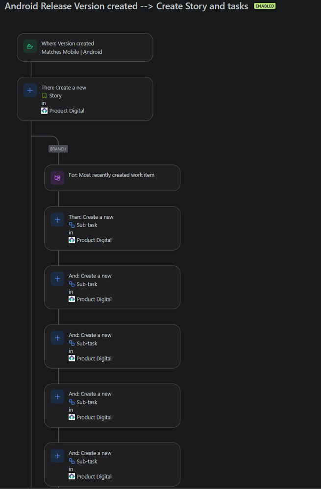

My automation is creating two stories when I have only got the one in the automation, can you advise what I'm doing wrong here please :)
Automation:

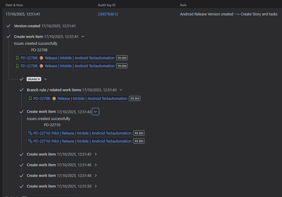

Aduit Log: Showing two created (but with same Key ID?)

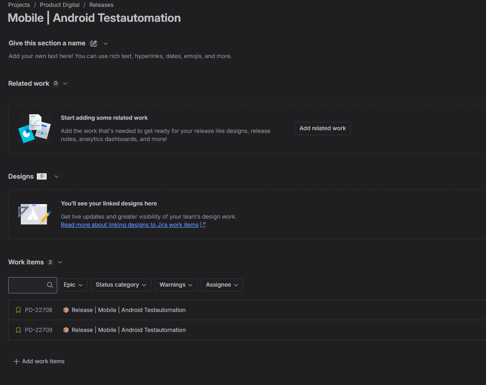

However, in release - its two different tickets?

I found the issue. I have 2 rules both using a similar trigger word (oops silly me)
I have Mobile | iOS and Mobile | Android and they are both triggering I believe due to the word mobile.
I didn't realise I can't use a string here. I tried to update using "" but this didn't work - any way to use a string in this? Or do I need to have a unqiue starting word?

Don't have spaces in the Release title. Go with something link Mobile_Android and make that the search criteria.
Or possibly, Leave the titles as is, but only search for Android and iOS. But that might not be enough??

Based upon the work item keys shown in the audit log, this seems to be a timing problem of some type:
  • story PD-22708 is created
  • and when it is branched to as the most-recently-created item, the next key used for the sub-task is PD-22710...
  • which means the story PD-22709 was created in the time between those two steps, which appears to be over a time of around 2 seconds duration
Some things to check are:
  • Look at the history for PD-22709 to learn...
    • who created it and when, relative to the other work items
    • when it was assigned to the version you show
  • Look at the complete rule audit log to see if it triggered twice in rapid succession
  • If your rule has been edited / published several times, it could be "glitched", causing the duplication AND not logging it
    • The way to check for this is to disable your current rule, and re-create it from scratch
    • Then test to see if it has the same symptom
