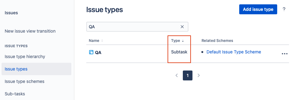

For the QA task to be a child issue, you need it to be a subtask issue type. In the example below I have created a QA issue type that is a subtask:

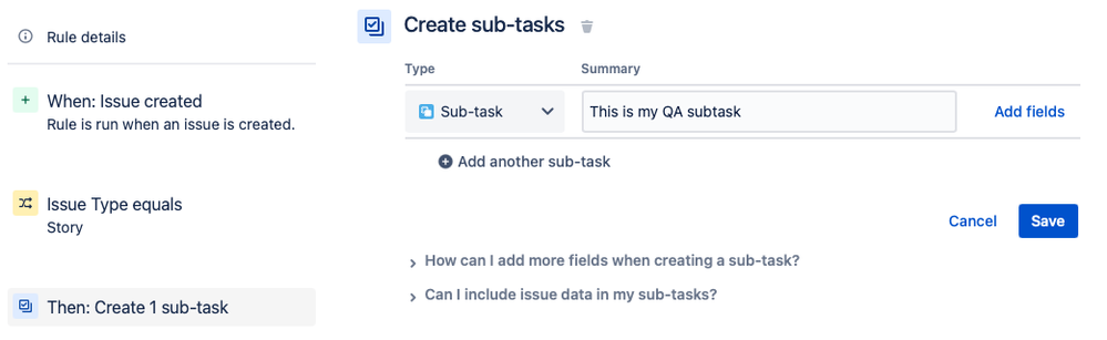

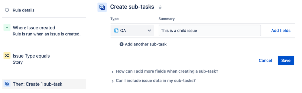

You can then create QA subtasks through Automation:
Depending on your configuration, you may also not want to create a dedicated subtask for QA tasks and just use classic subtasks:
