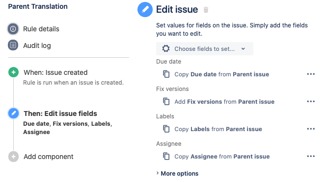

I am trying to implement a simple automation rule and I can't figure out why it's not working.
My goal it to set this up so that if you just create a subtask it will by default apply the same tags, due date, assignee, etc, as the parent issue (either an epic, or regular issue).
I thought this was very straight-forward and just set up the following:
When: Issue Created
Then: Edit fields –>
–> and for each field I have selected, "copy from parent"
What could I be doing wrong?
Edit: additional information.
Here is a screenshot of the automation rule that I created. If I look at the rule audit, it says that it executes successfully but, "Can't find issue to copy from"

Evan
July 6, 2020
Thanks! I know I have a lot to learn, but I'm excited to get going!
I feel like this should be simple compared to everything else Jira is capable of, so it's making me feel silly that I'm struggling.
Bill Sheboy
July 6, 2020
Hi, @Evan   -- Did any of the fields copy from the parent?
Also, please consider adding a condition after the trigger to ensure that the issue type is a sub-task.  Otherwise, other issue creates will attempt to process this rule's copy fields.

Simmo
July 6, 2020
Hi @Evan ,
The advice that Bill gave you is correct. I would have a guess that the issue that failed your rule wasn't a sub task and so we couldn't find the parent issue because there wasn't one. The best thing to do here is to add an issue condition that checks it is a sub task before trying to edit.

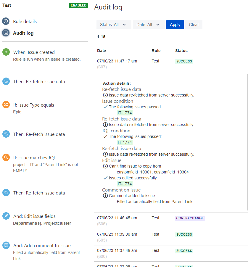

Christian Völker
June 7, 2023
Hi, im facing the same issue and nothing helps. I already included now that it checks if the Parent Link is existing, but still I get the the information can´t find issue to copy from. See picture below:image.png
Do you have any idea what i can do that it works?
