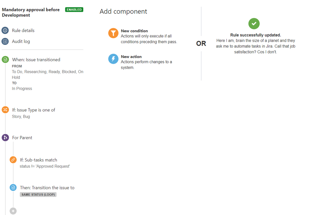

This is company managed project so I cannot directly add conditions in the workflow (it is set to read only as many project used the same workflows). However, I can use automation for my project.  I tried using following automation, but it still allows to change the parent story/bug status to In Progress, even is sub-task is not approved.

Your response on automation is helpful. Can you help me figure out how do I set the variable for this transition to happen. This would meet what I am trying to achieve.
Pls check the screenshot I shared before. That automation conditions are not doing what I wanted.Subtask approval.png

Hi @AT ,
This should work. You just need to match all the correct statuses.
In your case the JQL to be used in the "Related issue condition" is something like this:
issuetype = Approval AND status = "To be approved"
