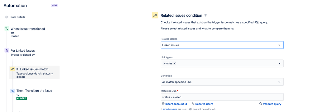

  3. Create the following automation rule:
This would be the rule background:
  • Trigger: Select the automation to be triggered when any issue is transitioned to "CLOSED".
    The intention here is to trigger the automation when any of the issues on project-2 or 3 is moved to the status Closed, or any status you selected to be the final status.
  • Branch: Add a branch to apply an action to the original issue on project 1, using the link type for reference.
  • Condition: Add a linked issue condition to confirm that all the issues linked to the project-1 issue are closed.
  • Action: Move the original issue on project-1 to Closed.

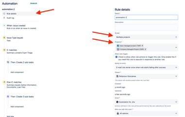

I have another concern here, we don't want to implement this globally so can I add another condition for applying this automation to specific projects?
Petter Gonçalves
June 27, 2022
Hey @Madhankumar K
Once your automation rule is created, you can go to the rule details and properly set which projects should be included in the scope of the automation:
Let us know if you have any questions.
Madhankumar K
June 30, 2022
Thank you, It worked.
