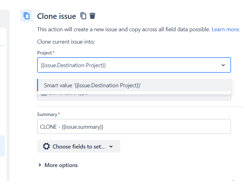

I now have a project that has a Project Picker field type on the bug screen, to allow a user to choose a destination project. I want to use the value of that field in my automation rule to determine which project to clone into, but the Project field in the clone step doesn't want to accept smart values.

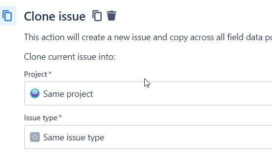

I can type the smart value for the field into the Project field in the rule, but as soon as I move out of that field, it immediately changes back to Same Project.

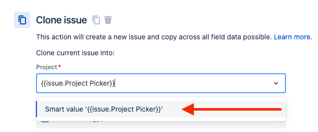

Hello @Esther Strom
You need to click on the gray highlighted area that says Smart value '{{issue.Project Picker}}' to push the smart value into the field.
