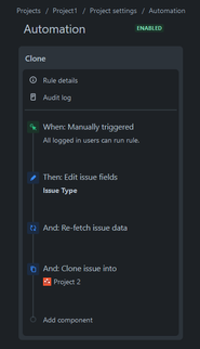

Hello @Dave Symonds ,
I was able to replicate your behavior and was able to resolve it by adding a Re-fetch issue data action before the Clone issue action:-
Give it a try and let us know how it goes.

Dave Symonds
November 20, 2023
Arg of course - thanks for that - all good
