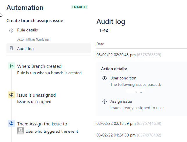

I have automation which should assign issue to user who triggered that automation, but it always fails with message 'Issue already assigned to user'. Issue is unassigned and passes previous test where that issue assignee is tested against being unassigned. If i put dedicated user to be assigned, automation works fine.

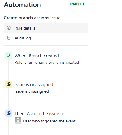

I meant that i changed trigger of that automation from Branch created to Comment Added, which caused automation to work properly. Then I set automation rule back to what it used to be as seen in below:
And created new branch which triggered rule which audit log is below

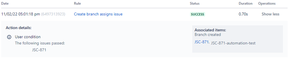

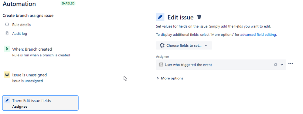

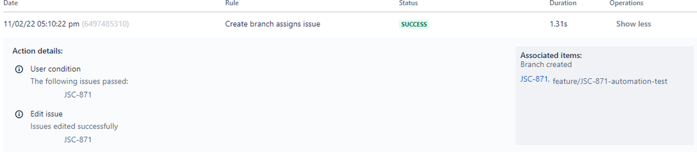

It looks to me that whole assign issue task (Then: part) was not run in automation. Then i tried using Edit issue to explicitly assign ticket to triggering user.
Log looks like below, but story is still unassigned.
I am wondering if actual user is even available in Create Branch trigger or maybe there is something wrong in it.

So you're log is showing that it was successful and the issue was edited. But you're saying that when you go to view the issue the Assignee is in fact still unassigned? It really isn't making any sense. Clearly the rule is triggering correctly and you're getting past the issue unassigned condition and the action is executing. I can't understand why the assignee would still be empty after the rule runs. Can you look at the history of the issue and see if there's anything in there that would give a clue? Also could you manually see if you can assign the issue to the user that triggered the rule via the branch being created?

It is exactly what i am also wondering. Rule is run successfully, but assigning does not happen.

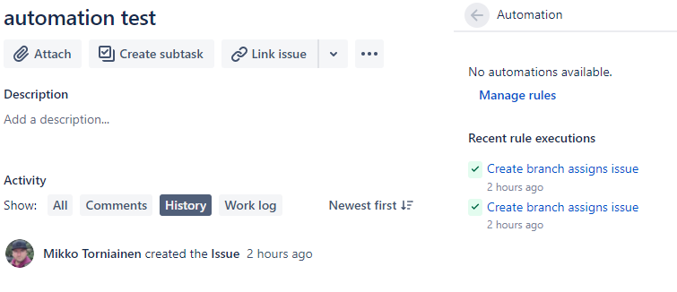

History is empty as seen below. Automation has been run few times as i have testing this.
image.pngI am able to assign this is manually to me (i was the one creating different branches). Also, i can modify rule to assign it directly to me when rule is run and that will assign it to me also. Only time it does not work is when i try to assign this issue to the one who triggered the issue and trigger being Branch created

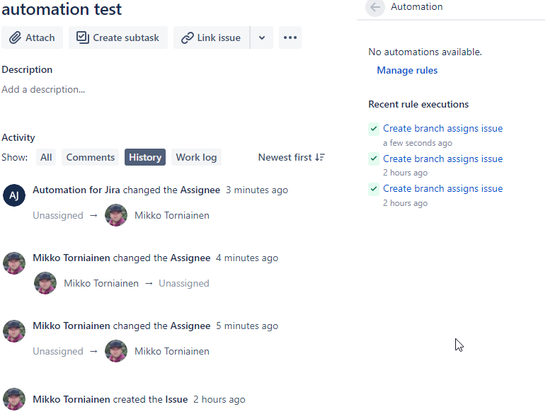

Below is history after i first manually assigned it to me, then i unassigned it to make rule successfully and last action is when i modified rule to assign issue to me when Branch created event is triggered.
So, i am thinking issue assignment does work but for some reason Branch created triggering rule with action to assign issue to User who triggered the event does not work properly. Weird.
