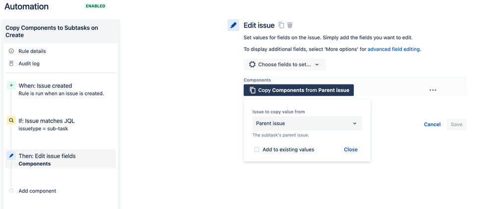

I've created an automation that upon creation of a subtask, it should automatically copy the parent task's Component field to the subtask.

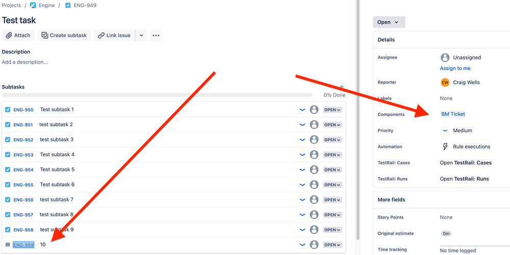

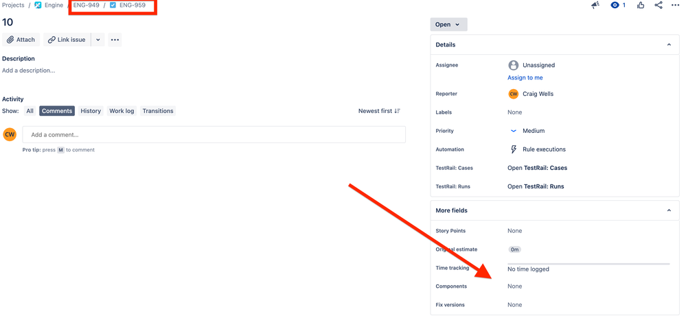

However, this doesn't seem to be happening for some reason. Whenever I create a subtask on a parent ticket with a Component filled in, it doesn't copy over the components.
Screenshot 2023-03-03 at 11.29.01 AM.pngScreenshot 2023-03-03 at 11.29.19 AM.png

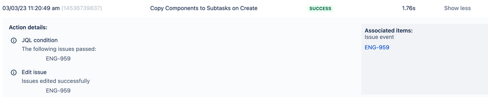

The audit log says that the operation was successful, which clearly it didn't do what it was supposed to do.

  • If I set it to a specific component instead of copy from parent, the rule correctly applies the specified component to the subtask on creation
  • Adding a refresh prior to the edit issues action doesn't do anything
  • Switching it to a JQL condition (as it's currently set to) didn't make a difference. (Originally it was set to Issue fields condition where type was Subtask)
I'm at a loss as to why this isn't working. It's clearly identifying the ticket as a subtask upon creation, and when using a specified component works correctly. I do not understand why the Copy from Parent issue doesn't work.

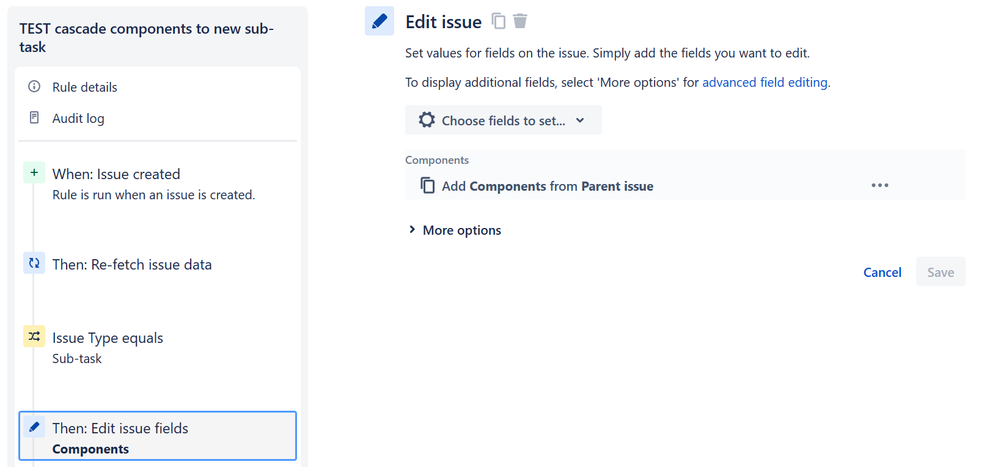

I just tried your rule scenario, in a company-managed project, and it worked for me.  I included a Re-fetch action after the trigger to confirm the data re-loaded prior to the condition and edit action.
I recommend re-creating the rule from scratch to see if that helps, as rules sometimes get "glitched" and broken from too many edits.

Just reaching a bit, but maybe click the box to Add to existing values in the rule?
