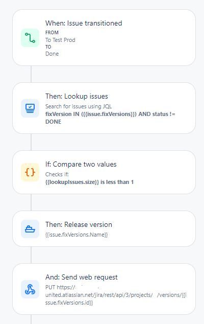

I am trying to create an automation to release a fixVersion when all issues are done and then change its name when released. However, I am unable to do so.

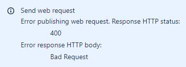

I am using a PUT API call to change the version's name field upon release but the following error keeps appearing:
Error publishing web request. Response HTTP status: 400
The URL I am using: https://MyCompanyName.atlassian.net/jira/rest/api/3/projects/ProjectName/versions/{{issue.fixVersions.id}}
Notes:
- I am trying to keep the {{id}} dynamic to make this automation as scalable as possible
- The trigger happens when an issue is moved to DONE status
- My company uses several projects, this automation is for a particular one
You can check current flow here:
Any help would be very much appreciated, thanks!

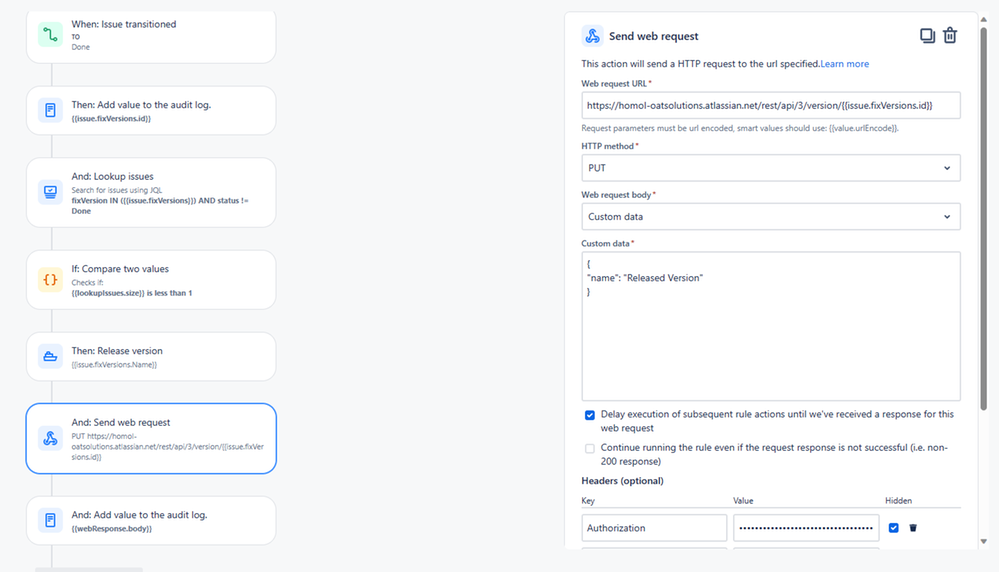

@Alex Cadevall , Welcome to the Atlassian Community!
According JIRA API REST documentation your URL is wrong. Please, try to use this URL: https://your-site.atlassian.net/rest/api/3/version/{{issue.fixVersions.id}}
I did some tests and works fine. Consider this documentation to Fix Versions API in Jira Cloud: Update Version - REST API

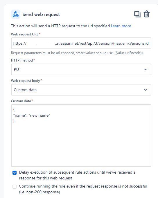

If you want change only the name use this custom payload:
"name": "NEW RELEASE NAME"
Hope this helps you.

@Alex Cadevall
Have you checked your token or your permissions in the project where this version is presented.
Ensure that you are in administrators project role or consider try another Jira API TOKEN. I'm leaving an attachment of my rule that is working so you can just take a new look and see if is similar to this one. Then you can try to change your API token to see if your the current problem is associated with your token or permissions.
Hope this helps

Yes, it was both a URL problem and token problem.
For the URL I had to simplify it to the one indicated by @Fernando EugĂȘnio da Silva URL: https://your-site.atlassian.net/rest/api/3/version/{{issue.fixVersions.id}}
Regarding the Token I had not added Basic in front of the base64 coded email+token.
Thanks a lot for your help!
