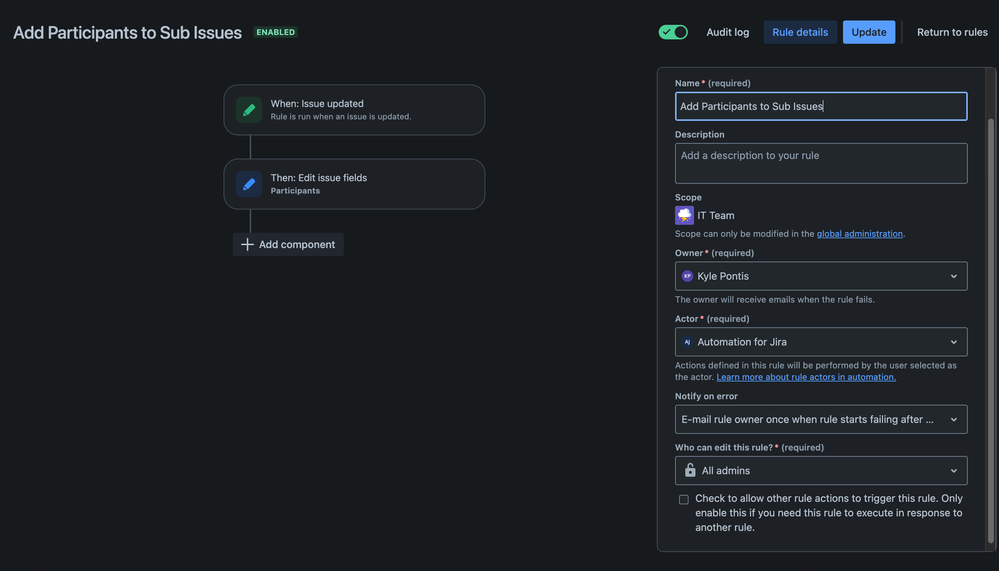

I have a very simple automation set up that is supposed to update all sub-tasks on an issue to fill out a custom field from the parent issue.
The workflow is only 2 steps.
When: Issue Updated
Then: Edit Issue Fields
The when trigger does not seem like it can be customized in any way. The Edit issue fields step simply has the selected custom field I made selected, and the action is to "copy from parent".
Seems simple enough. However, try as I might I cannot get the automation to fire. I have tried commenting on the sub task, I've tried changing its status, and its assignee. Nothing seems to trigger the automation to even attempt to fire.
We do have a security screen enabled for this project but I have ensured that the automation "user" is allowed to access all issues. Can anyone help me determine why this automation is not firing, much less working?

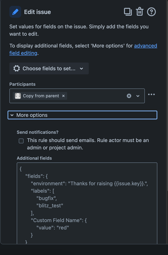

Hi Aaron,
Thanks for your help. I have attached images of the automation and its rules. Let me know what you think!Screenshot 2024-10-16 at 1.18.23 PM.png Screenshot 2024-10-16 at 1.19.37 PM.png

Hi @Kyle Pontis
Can you share a screenshot of the whole automation, please?
Any errors in the audit logs? a screenshot will help us too.
I just created a similar automation and the subtask gets the value from the parent.
Maybe permissions? who is the actor of the automation? is it Jira automation?
