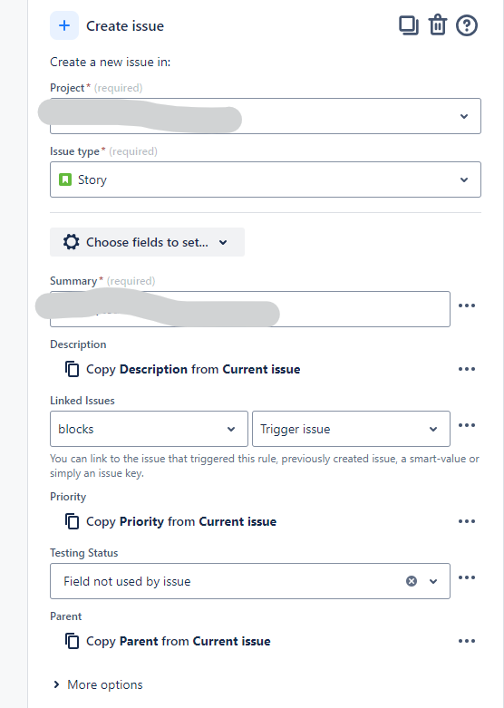

Hello, I already have a manual automation (screenshot below) where it creates a new story in a different project. i.e. This manual automation is in the Automation section of Project ABC, and the screenshot below shows that it'll create a new issue in Project XYZ.
I want the newly created issue in Project XYZ to have a status of "Ready" instead of "Open" but unsure how to do that. Any help would be greatly appreciated!
What I've tried:
- created Automation in Project XYZ when a new issue is created, transition status to 'Ready'
- created Automation in Project ABC where added a component after the 'then' to also 'then' transition issue to 'ready' status

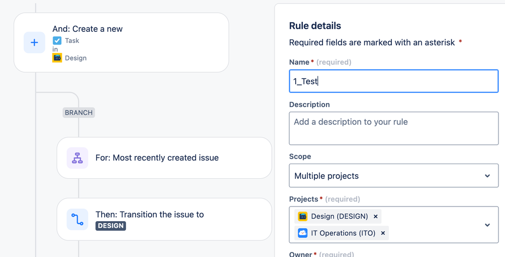

@TJay.Gerber The below sample rule should work to meet your requirements, make sure that the scope of the automation rule is 'Multiple projects' with both ABC and XYZ projects included. You have to go to the 'Global Automation' page to make the change.
TJay.Gerber
April 12, 2024
Ah, thanks, Gikku! That was my worry that it'd have to be in 'multiple projects' as the scope. I have to go to our jira admin for them to allow that and then go back to them to make any edits since, once it's in multiple projects, it locks out any edit access.
