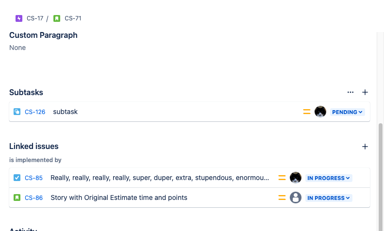

Subtasks means something specific in Jira. It is a special type of issue that can be a child of another issue. That is separate from using the generic issue linking functionality to link two issues together. The two types of relationships are shown in different groups in an issue.
The automation for what you want to do is different depending on whether you really mean subtasks or your really mean linked issues.

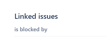

sbeaulieu
August 22, 2024
Thanks for the information. That would be Linked Issues that would block the Main one, The 'Asset' one.
