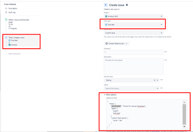

Here you might use the Automation rule there you can create subtasks and in the addition field you can write logic and take information from previous subtask and make changes in that and update it for subtask. Here you need to explore more.
Option2: If you have script runner field then you can write scripted postfunciton for subtask creation there you can write script to take the information of previous subtask and update

Thank you very much @Sachin Dhamale - while we weren't able to use your exact suggestion, it still helped us with another case we were looking at.
We also found a solution to both our problems. Instead of using the "create issue"-action, we've used a JQL to find the sub-task of the issuetype we needed and then used the "clone"-action, just with another issuetype.
