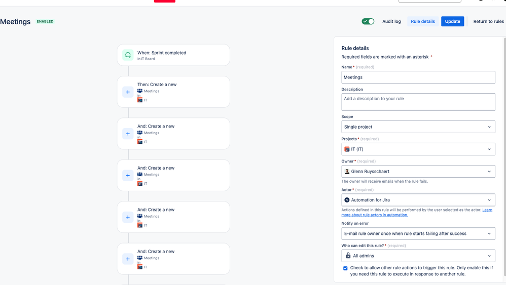

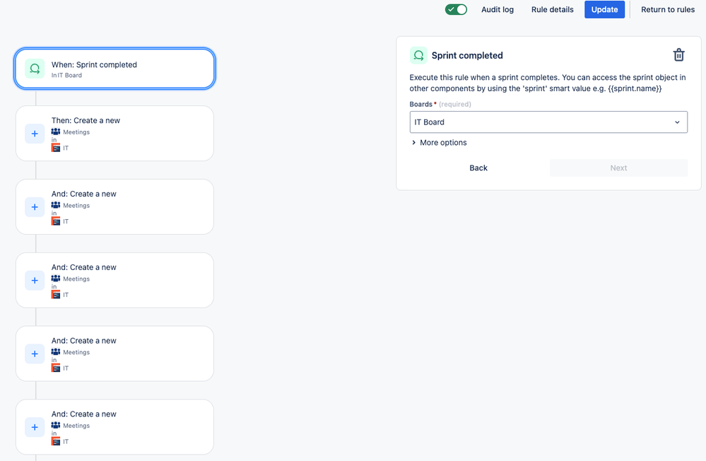

I have an automation which creates some tickets in a new sprint, after completing a sprint.
I noticed for two sprints already, this has not been triggering anymore, even though it used to work on other boards (the IT Board is a new board).

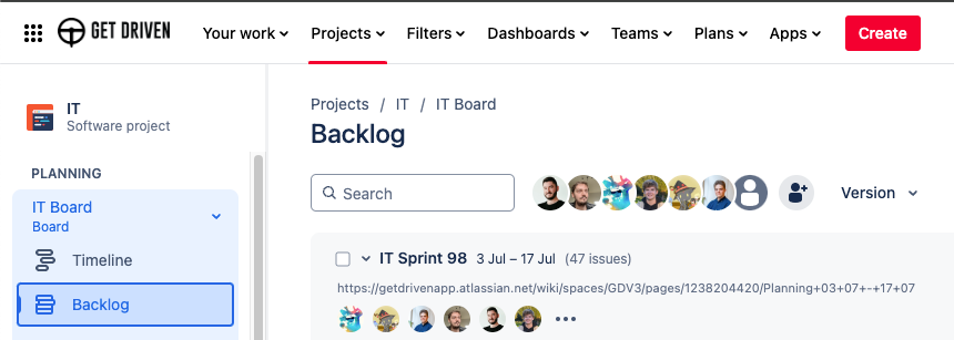

For example today I completed and ended a sprint, this sprint just started

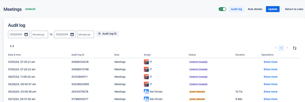

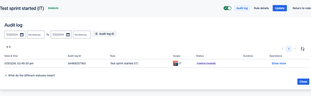

But in the audit logs it does not appear for the automation

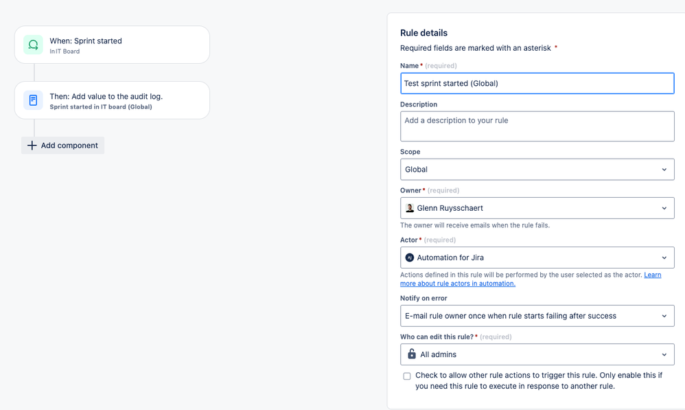

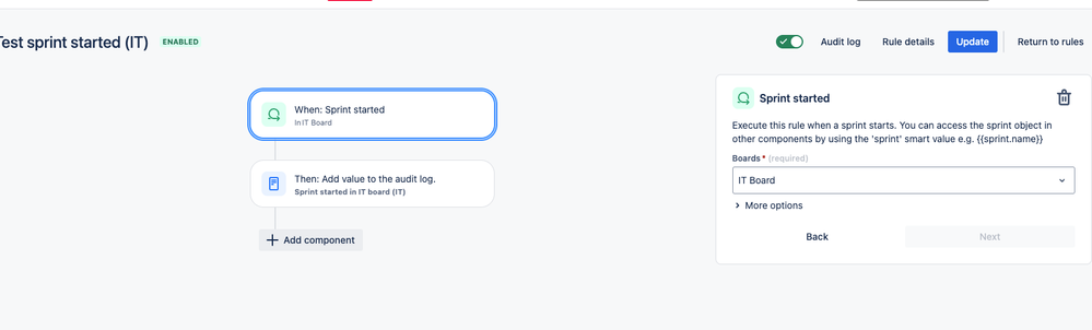

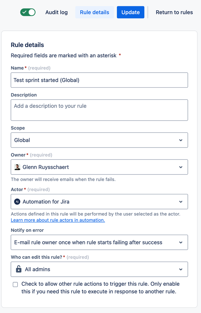

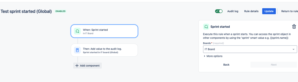

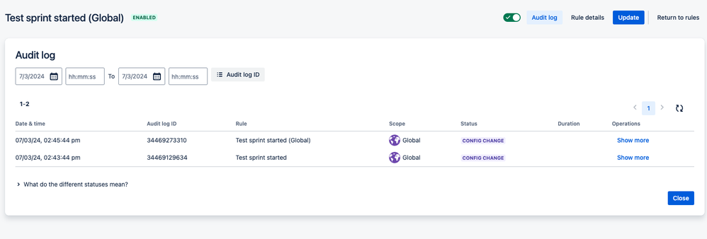

To double check I created 2 test automations, one with global scope and one with IT scope. These would print a log when the sprint starts.
After starting the sprint, they did not run.
Global:
IT scope:Screenshot 2024-07-03 at 15.04.57.png

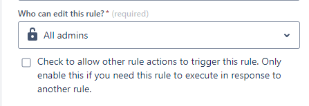

Not sure what might be happening to trigger the new Sprint, but it might be that the automation rule is checked to be allowed to run when something else triggers it. Take a look at the Rule Details and see if the box is check to allow it to be triggered by another option.

Hello @John Funk ,
The checbox is not checked.

Figured as much. You should check it. And them Update. And then test again.

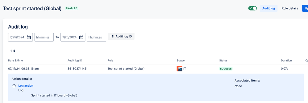

I have a test automation in place:
This one got triggered
But the automation that should trigger, does not:
Any ideas?

I have now changed the scope in rule details for the automation that is not triggering to "Global", with the when sprint completed still on the "IT Board".
When this sprint completes, I will check again (as this sprint is currently in use by the team).

It seems like changing the scope to Global fixed it.
