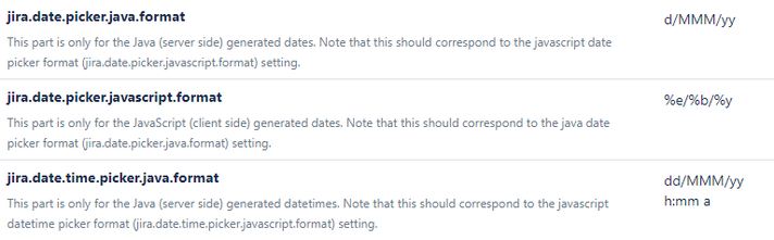

I have been trying out similar smart values using dates which has not been very successful. The problem I have alteast is that your jira instance i set to another date format. You can check this by going to Jira administration -> System -> Advanced settings
My smart values behaves just as you describe when i try to format it by myself. I can only use the default format. I don't know why it behaves like this.

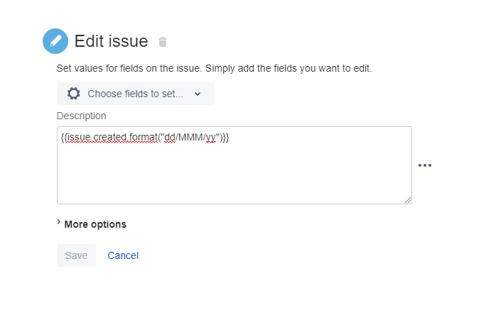

Can you try to change the rule into writing the date in the description or in a comment? image.png

Yes, but I just wanted to see if you could print the value into a simple text field so the absolute basic is working.

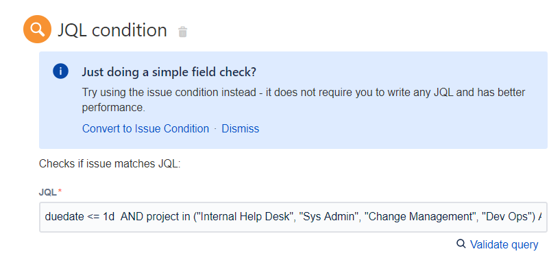

Can you screenshot the entire rule you are trying to run?

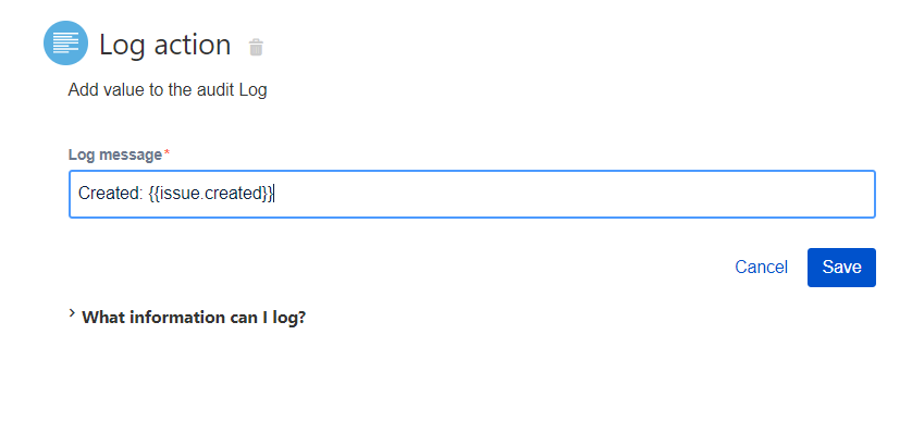

I have used to log the result, and here is the result  Created: 2020-01-15T13:49:38.6+0200

Hm. I can write {{issue.created.format("dd/MMM/yy")}} and it works fine. I can also write  {{issue.created.format("dd/MMM/yy h:mm a")}} so I can't really replicate the issue. The only time I can get a similar error is when I try to set a date-field to another format that is not defined in the jira instance.  So I don't think I am able to help with your kind of issue.
One question though, since you want to automate this, why don't you run a scheduled trigger? This will allow you to use JQL without any other triggers needed. Maybe you already thought of this or maybe you have a better solution, just making sure that you know that the scheduled trigger exists. :-)

It's mainly scheduled trigger, just I moved the braking part of it in different automation to see what's the issue, and how to solve it.
