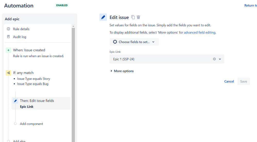

Hi @Colin
I tried the following automation and it seems to be working. See if this helps

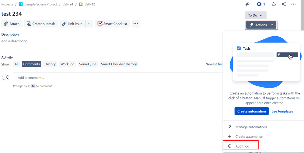

@Colin can you please check if there are any other automations in place?
You can see all the automations that were triggered along with the details from the audit log under the actions button in the issue created.

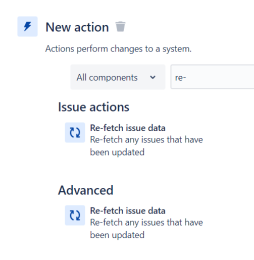

@Colin if that's the case then you can run the  "re-fetch" action before assigning the epic and see if it resolves your issue.

Colin
April 12, 2023
Hi @Najm Polaris
Fantastic, that got it and it's now working - thank you!
