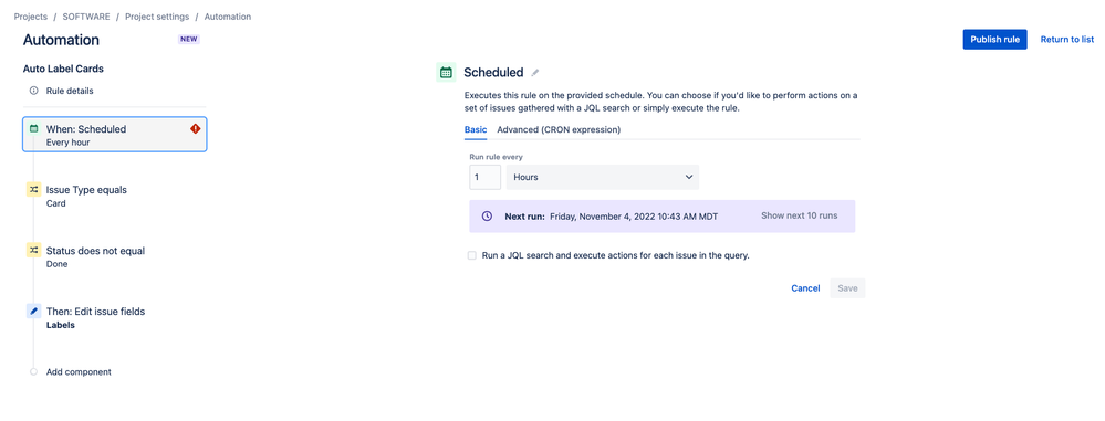

I am trying to create this basic automation, that every hour will add the epics labels to its card children.  However, the automation won't publish.  When I publish, it puts an error icon on the schedule.  However, there is no error message. Any ideas what the problem could be?

Tested this! some issue-specific actions such as edit issue will only work if you use a jql in the schedule. I'd say check the 'run jql search' box under your schedule trigger and add the jql "issuetype = card AND status != Done". Now there's no need for the two conditions, as the schedule will already filter only those issues.

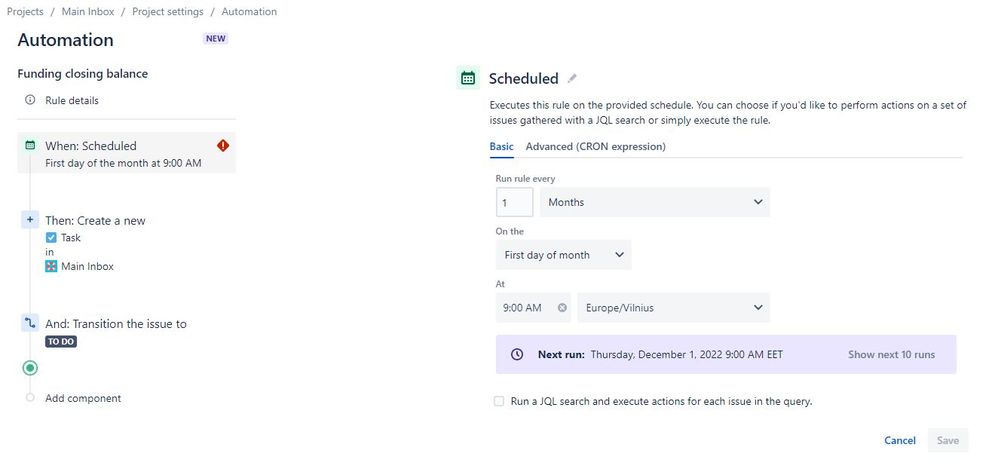

I'm trying to create a simple automation which will create an issue on first day of every month. When I try to publish the rule and turn it on, I get the same error flag in the trigger (schedule) component without any details to what exactly this error refers to:
Never had this issue before. Tried to use Advanced (CRON expression) instead but with no success.

What is the workflow for that type of issue? Is To Do a valid status for the workflow? Is it the status that issues start in after being created? If so, you don't need to have a step to transition to that status.

Yes, To Do is a valid status in the Workflow for this type of issue. By default, issues are being created in Open status, and afterwards are moved to 'To Do' status.
Not really sure what's wrong with it. The same approach works in other automations rules but where triggers are not scheduled but, for example, 'Issue created' or 'Issue edited'.

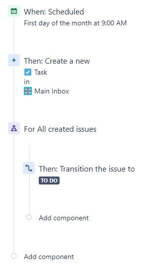

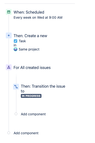

I tried creating a similar rule (Schedule, Create Issue, Transition Issue) and got the same error. I'm not sure why that method is showing a failure icon when trying to publish, but I found a method that does appear to work.
Use a Branch / Related Issues / All Created Issues and put the Transition within the branch.

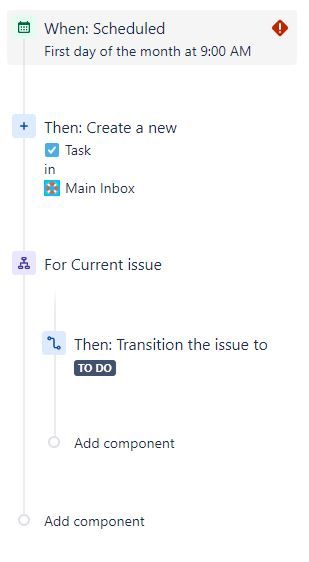

I actually tried to use the same approach with Branch component, but used 'For Current issue' and still got the error message, so thought that Branch doesn't solve it:
Now I tried using the method suggested by you - Branch component with 'For All created issues' and it works :)
The issue seems to be solved, thank you!

The problem with the rule you have defined is that you don't have a "Look up" action. Every hour, it is executed, but you must have a JQL to select the issues you need.
You can also use a different trigger to run the rule when an issue is created.
