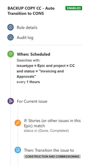

Hi.  I am trying to modify an existing automation rule (AR) that has been working since it was created three years ago.
This scheduled automation rule is runs every one hour and retrieve records where the "issue type equals Epic and project equals CC and status equals Invoicing and Approvals."
If all of the stories linked to the Epic are in "Done" or "Completed" status, the Epic transitions from "Invoicing and Approvals" to "Construction and Commissioning" status.
I need to add a new condition to this rule that checks if the Operations Contact field is empty.  If it is not, the Epic transitions from "Invoicing and Approvals" to "Construction and Commissioning" status, just like the current AR does.  However, if the Operations Contact field on the EPIC is empty, then the Epic status doesn't change and an email is set to a group mailbox to populated the Operations Contact field.

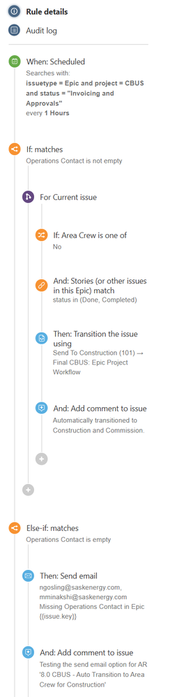

1) If/Else - it would send email for Epics where the "Operations Contact" field was populated. I read the If/Else functionality can be tricky so I tried simpler approach (#2)
2) Multiple Branches - in addition to the conditions in the current automation rule, I add a check for the Operations Contact.  This one was looking promising however when I was digging into the audit logs I noticed that an email was sent for an Epic that had open stories and no operations contact.  Because I used "And" and not "Or" I would have expected the Epic to not pass the first condition in the second branch and do nothing.

Hi @Nicole Gosling
I would expect the updated rule you show with the If / Else block to work for this scenario, although the branch on current issue is not needed...and neither is the condition on the Else: you could just assume the field is empty.
Without changing anything, would you please post an image showing the audit log details for the rule execution which did not work as you expect?  That may provide some context to help explain the symptom.
Regarding multiple branches, I would not try that for your scenario.  Such branches execute in parallel and so it will be difficult to diagnose what is happening for any timing-related problems.

@Bill SheboyThank you for your prompt response. I reviewed the automation rule using the If/Else functionality again, and it appears to be functioning correctly.
We use an API to import data from a another system ("Source System") every 15 minutes, including the Operations Contact. I believe my user received multiple emails for the same Epic because although she entered the operations contact in the source system, the API didn't update in the Jira Epic. I have created a ticket for our AMS team to investigate potential errors in the API.
I'm curious why the branch and ELSE condition are not necessary. We need to ensure that the child tickets are in Done or Complete status and that the operations contact field is populated before the Epic can transition to Construction and Commissioning status. Is there a simpler way to achieve this?

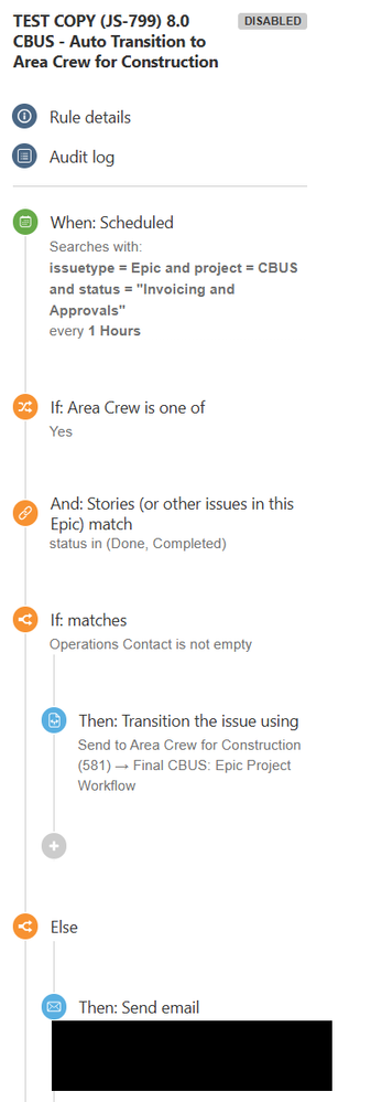

Thanks for your response.  If I understand your suggestion correctly, this is how I can configure the automation rule without using a branch. Correct?
Next question. If Area Crew = No, I need to use a different transition but everything else is the same.  Would you suggest that I create a separate rule to keep things simple or is there a way to work that scenario into this one without complicating things?

Bill Sheboy
March 28, 2025
Yes, that updated rule looks correct.  Well done!
Regarding "Area Crew", with the Data Center version of automation rules, I do not believe if / else blocks can be nested yet.  Given that, there are several alternatives...
Creating separate rules will potentially create rule maintenance / update problems, as they could get out of sync.  Although it will be quite clear what is happening in a single rule.
Another alternative is making the Area Crew test part of the if / else block tests.  To do this, I recommend pausing and creating a logic table to ensure the cases are all covered, in the correct order, and then testing fully.  For example:
         \    Operations Contact
Area Crew \ Is empty Is not empty
No send email transition to X
Yes ??? transition to Y
A riskier approach (in my opinion) would be using a REST API endpoint to perform the transition and a conditional expression to select the destination status.  That would essentially inline the work.

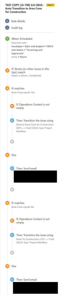

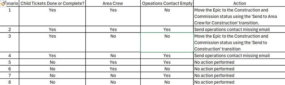

Thanks @Bill Sheboy I like the idea of having one automation rules however I am not sure it will evaluation the If/Else statements as I intended.  I came up with 8 scenarios. The are:
And this is how I configured the automation rule:

Bill Sheboy
March 28, 2025
Well done, and...creating the full logic table helps to use techniques like from Karnaugh Maps to decide what / when to test...
Viewing the table shows only the cases where "Child tickets are Done or Complete" do something, and so moving that test first (before the if / else block) helps.
Next, whenever the Operations Contact is empty, the email is sent.  And so that would be the first test in the if / else block.
Finally, the block may test Area Crew's value last is it impacts the transition-to status.
Like Nicole Gosling likes this
