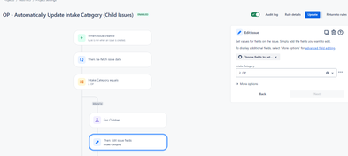

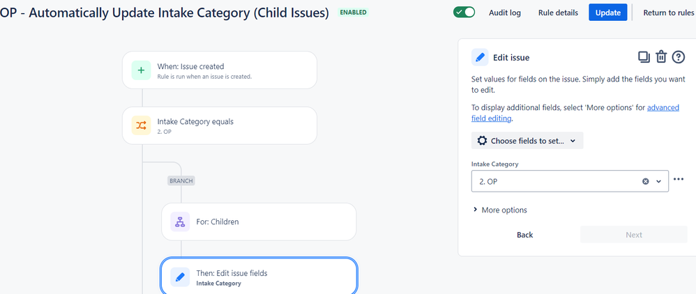

Thanks, Bill. We want to start with scenario 1 (and then future state iterate upon setup with scenarios 2/3). Here is a screenshot of the rule configuration to attempt at achieving scenario 1; the audit log shows no actions performed when I ran a test (In the test I first created an Epic issue type with the defined intake category > then create a child issue for this epic and the intake category field was not edited to OP).

Thanks for that information, Casey!
When using the Issue Created trigger, I recommend always adding the Re-fetch Issue action immediately after the trigger.  That trigger may fire so quickly that some data may not be available to the rule yet, causing the rule to not work as expected.  Please add that action and re-test your rule.
Also, please expand your audit log details with the "Show more" option and re-post the image.  That will show the specifics of what happened in the rule steps.

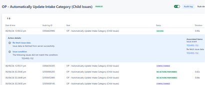

Thanks for the quick reply, Bill. I made the suggested edit (screenshot of updated rule here)
Rule Setup

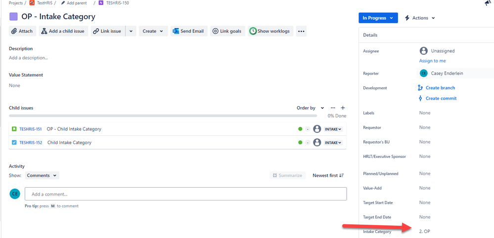

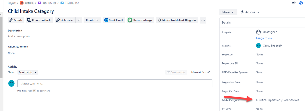

I created a new child issue and the audit log says successful (screenshot below), however the child issue's field of intake category did not get edited to 'OP' as we desire (see screenshot below of the child issue and the parent issue)
Audit Log

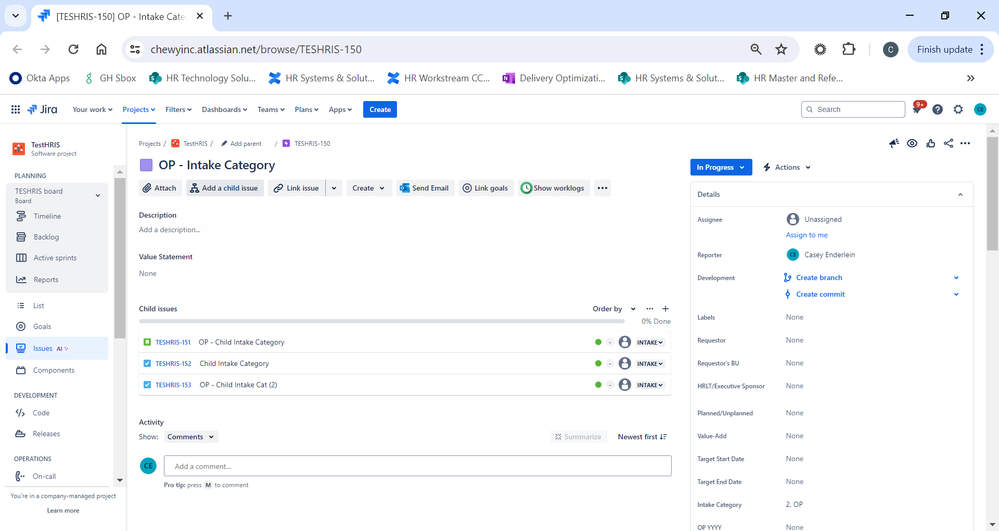

Parent Issue
Child Issue

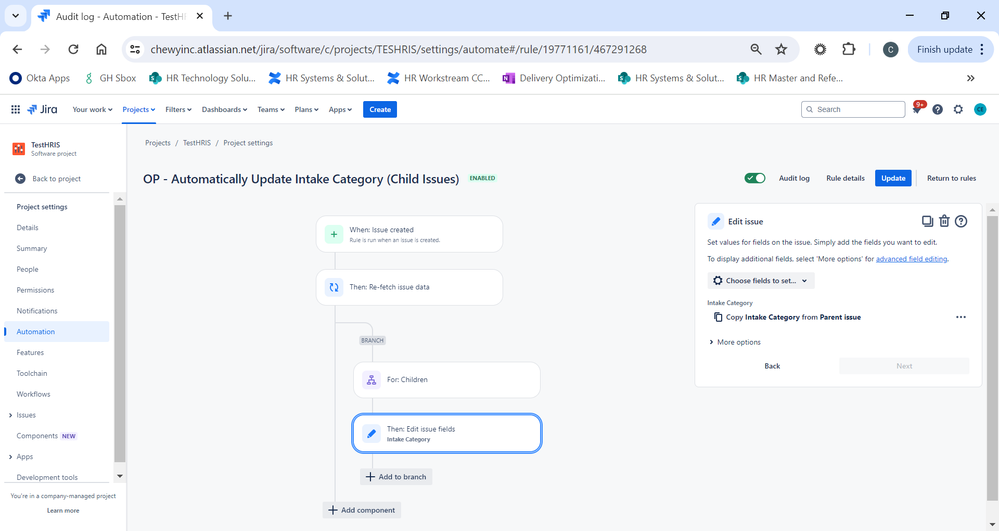

Hi, Casey.  Have you tried using the "Copy from parent" option for the field in the edit action?
Casey Enderlein
June 10, 2024

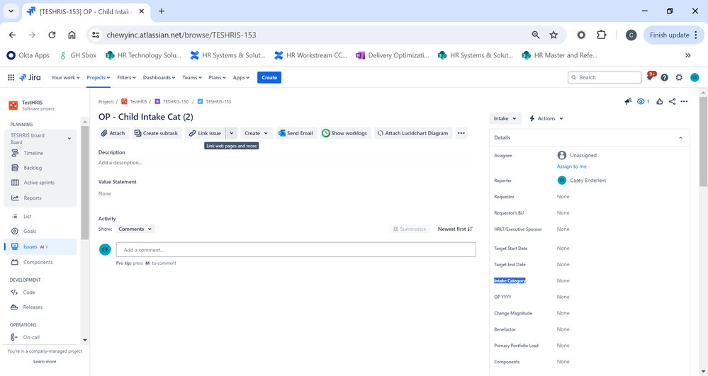

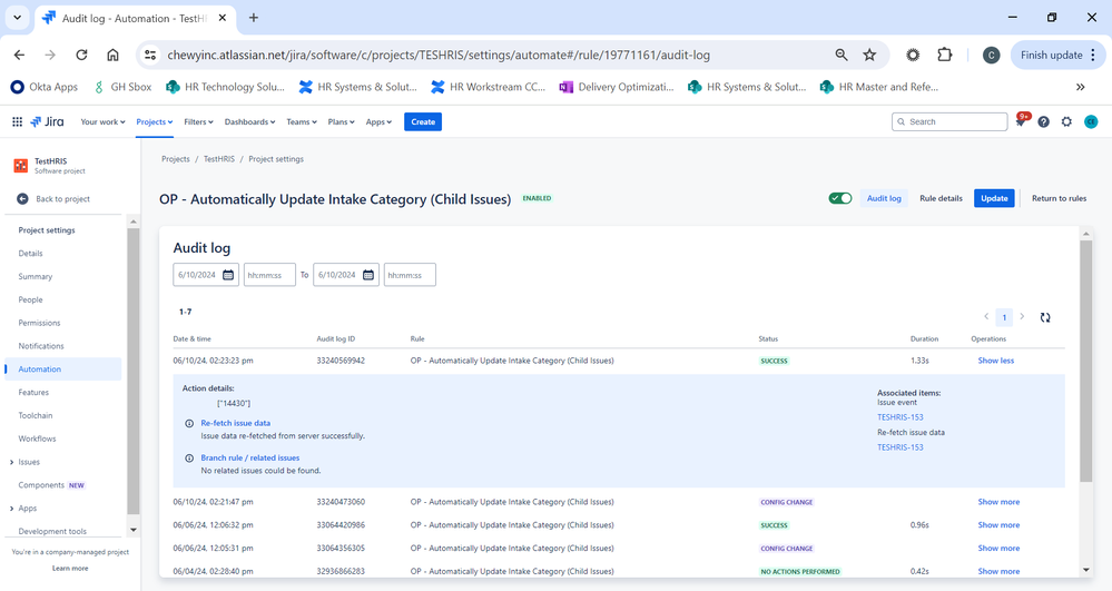

thanks for getting back to me! Yes I tried this and still not yielding the result -- here are screenshots of the rule setup, audit log, and the issue of most recent test (TesHRIS-150 is the Parent; TesHRIS-153 is Child issue). Based on the audit log is this a branching issue? Should I just remove the branch all together/this is not needed since the edit functions specifies copy issue from parent?
Bill Sheboy
June 10, 2024
Yes, that is correct: remove the branch to make the rule look like this:
  • trigger: issue created
  • action: re-fetch issue
  • action: edit issue, copying Intake Category from parent issue.

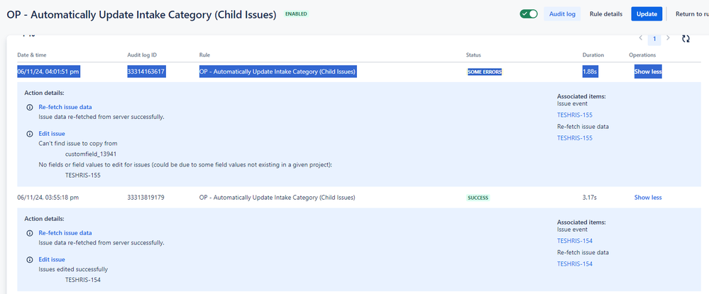

In running an additional test I am noticing this rule not working for all scenarios. The first test passed: I created a child issue and upon creation left 'intake category' custom field blank > when I finished creating child issue and refreshed page, it automatically edited 'intake category' field on child issue to match the parent selection of "OP".
Second test I ran failed with errors (audit log screenshot below): I created a child issue and incorrectly selected an option for custom field 'intake category'; I selected "Critical Ops/Core Services" for the child and parent has selection of "OP". I finished creating the child issue (refreshed page) and the intake category field did not override to copy the parent's selection of "OP", we still see the seleciton of "Critical Ops/core services", and received an automation email error.
Is this expected behavior for rule to only work if the custom field on child issue is left blank upon creation?
Bill Sheboy
June 11, 2024
Did the new issue TESHRIS-155 have a both a parent assigned and value in the parent's field at the time the rule triggered?

Casey Enderlein
June 12, 2024
Apologies, it looks like I did not select the parent when creating that test for issue TESHRIS-155. In re-running same scenario (created new child issue with accurate parent issue) this worked successfully and the intake category on child issue was changed via the automation from critical ops/core services to OP.

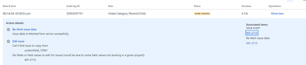

makes sense, thanks for confirming. As an admin I am noticing one thing, when an issue is created and there is no parent I receive an automation rule error. We understand not all issues will have a parent therefore don't want this to flag as an error... how can I adjust the rule to ensure this is not flagged as an error? Screenshot below of the error2024-06-14_14-03-59.png
Bill Sheboy
June 14, 2024
What do you want to do if there is no parent issue?
For example, if there are no changes to that field, you may add a condition to prevent further processing:
  • smart value condition:
    • first value: {{triggerIssue.parent}}
    • condition: does not equal
    • second value: leave this empty
