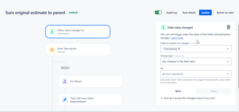

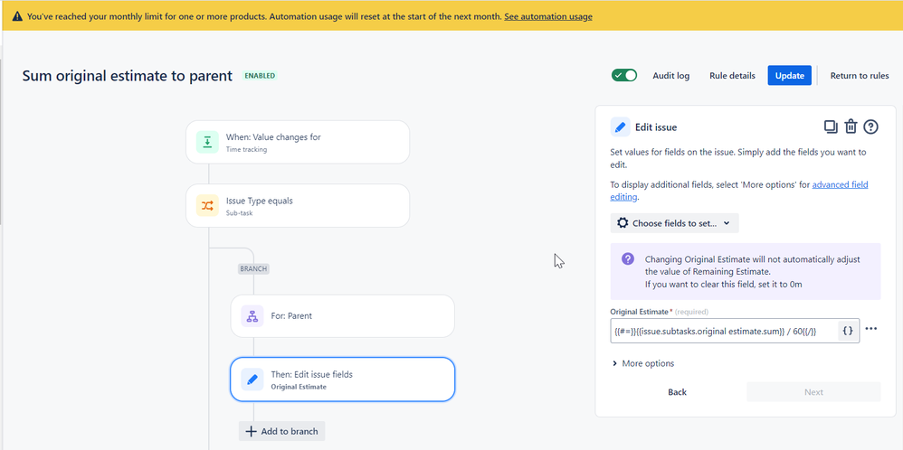

Hi,
I'm working on an Automation Rule, to sum all values from "Original Estimate" field from every subtask, and return the result in the same field of the parent issue.
I took a hint on this community post.  Here I got the line of code to perform the calculation.

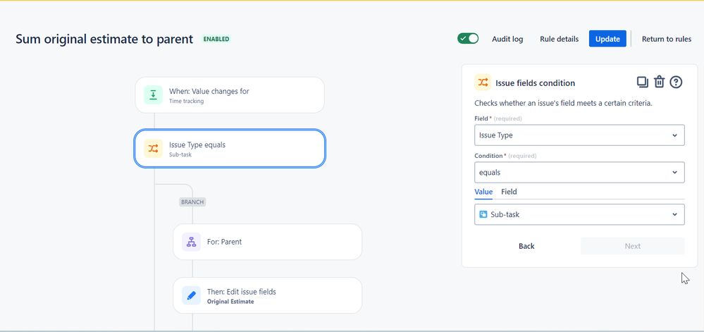

The rule is intented to work like this:

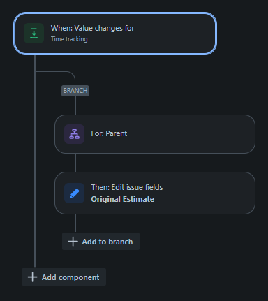

  1. The trigger is to create/make any edit to the issue
  2. Branch for Parent
  3. Perform the calculation and return the result

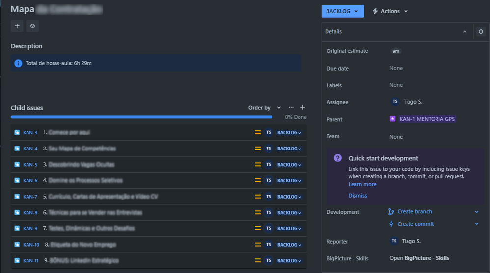

The task has 9 subtasks. For each of them I put 1 hour as Original Estimate, to make 9 hours in total, and make it easier to se if the rule could work.
The rule actually works; as I edit any of the subtasks' Original Estimate, the value for the task is updated.
Problem is, the result doesn't make sense.

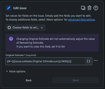

Using the following line of code
{{#=}}{{issue.subtasks.Original Estimate.sum}}/3600{{/}}

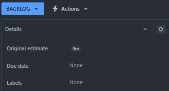

with 9 hours in total from the subtasks, I get "9m" or 9 minutes, a as a result.
What am I doing wrong with this rule?
Thanks in advance.

3 answers
Pasam Venkateshwarrao
February 20, 2025
Hi @Tiago S.
Thanks for reaching out to the community
you can try this automation rule
Hope this helps to achieve your query
Tiago S.
February 21, 2025

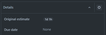

Hi @Pasam Venkateshwarrao
I made the rule following your example, and it worked fine.
For the given values (9 subtasks with 1 hour for each Original Estimate), the result is 1d 1h.
As far as I know, 1d = 8h by JIRA standards, then it's correct,
Thanks for your answer.

Duc Thang TRAN
February 20, 2025
Hello @Tiago S.
Can you try with this smart value ?
{{#=}}{{issue.subtasks.timetracking.originalEstimateSeconds.sum}}/3600{{/}}
Tiago S.
February 21, 2025
Hi @Duc Thang TRAN
Unfortunatelly, the smart value didn't work.
Duc Thang TRAN
February 22, 2025
Hello @Tiago S.
After reading your config instance here is 2 way to do it
{{issue.subtasks.timetracking.originalEstimateSeconds.sum.divide(3600)}}h
{{#=}}{{issue.subtasks.timetracking.originalEstimateSeconds.sum}}/3600{{/}}h
But I don’t tknow why you need doing this calculation because by default, Jira sums up the estimates via the field {{issue.aggregatetimeoriginalestimate}}.
If you copy all the estimates from your subtasks to the parent task, this field will end up doubling the total estimate.
Like Tiago S. likes this
