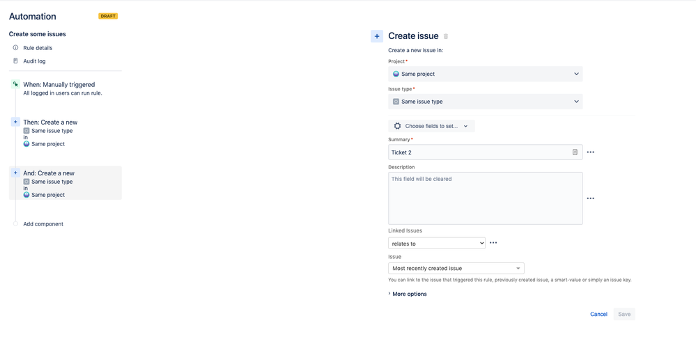

Developer from Automation here.
You should be able to achieve this use-case by using the "Linked issue" field on ticket creation, where as the link issue action would run after the new one has been created.
Something like this should work:
I hope this helps.
David Loszewski
July 27, 2020
@Yvan Martin Thanks!
This worked exactly as needed! Thank you!
