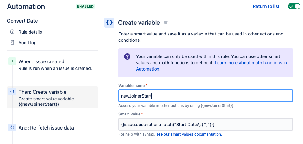

The automation goes like this: First part is a variable to scrape the date out of the description.  Screenshot 2022-08-19 at 12.10.13.png
This bit works fine and I do get exactly what I am expecting.

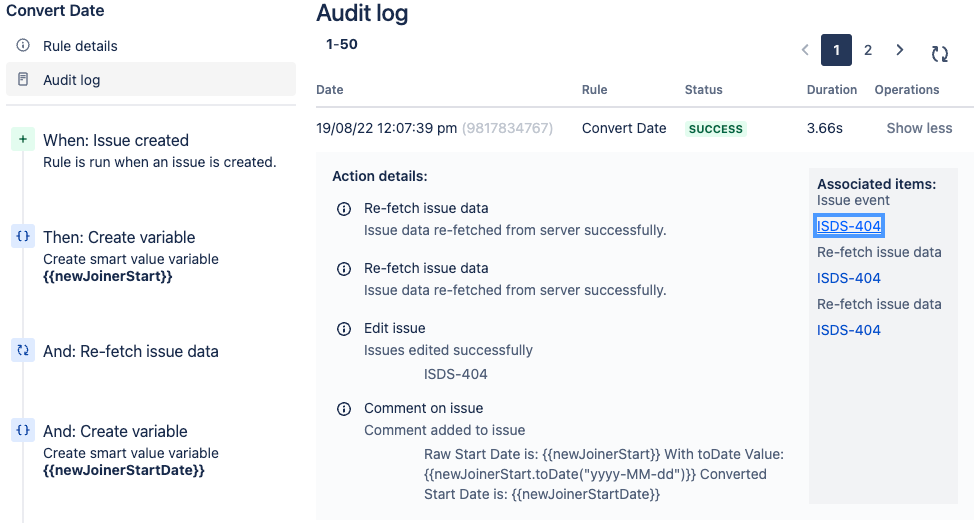

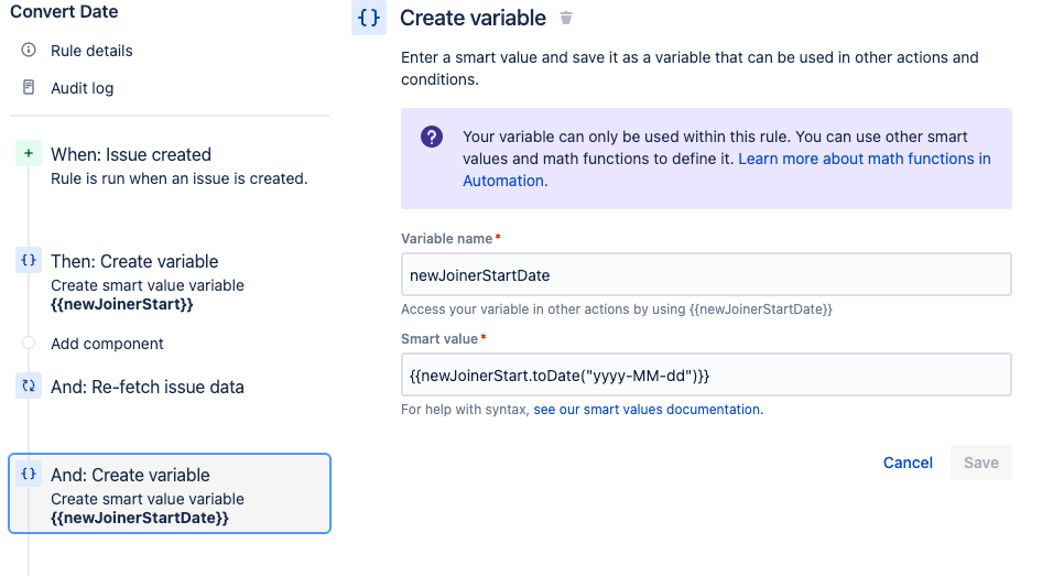

The next part of the automation creates another variable which I was hoping would be the date in a converted form, however, this value doesn't ever generate and the audit log doesn't show any error.

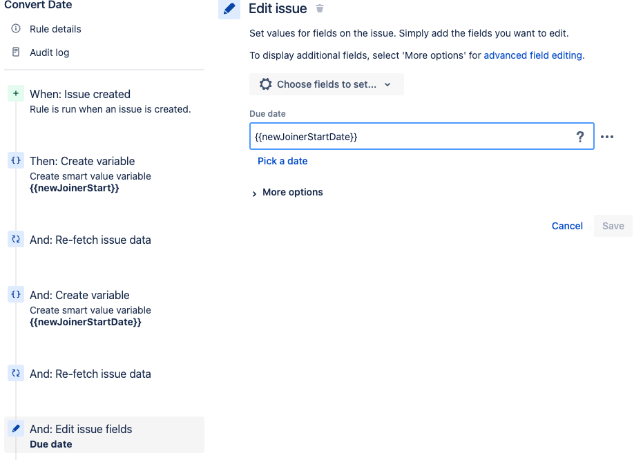

What I was wanting to do next is to take the newJoinerStartDate value created in the step above and edit the Due Date of the ticket.
This doesn't work as the value for newJoinerStartDate is blank.

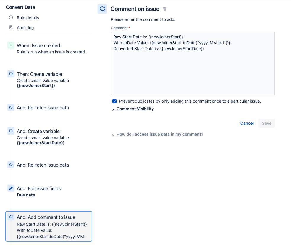

The final part of the automation and the element that will be removed is to update the ticket with a comment showing me what values were created for each of the variables.

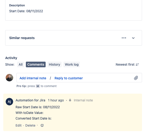

Screenshot 2022-08-19 at 13.06.11.pngThis updates my ticket to show this:
Screenshot 2022-08-19 at 13.06.56.pngThe initial value that is scraped from the ticket description is there and is correct, the problem seems to be when I try to convert that into a valid date format that the Due Date field will accept, sadly the audit log for this shows no errors which doesn't help direct me anywhere.
