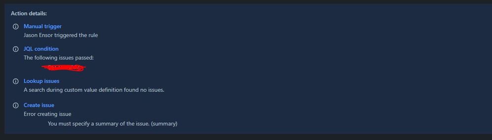

Hiya,

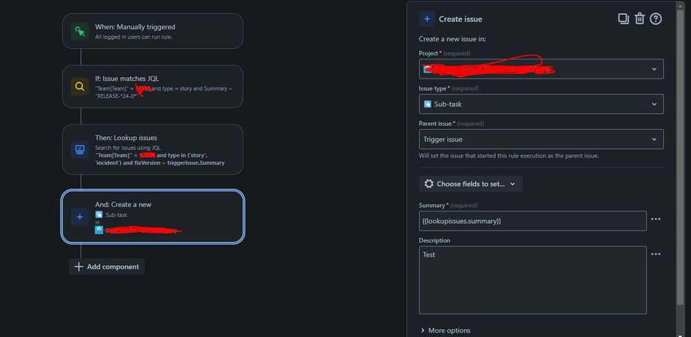

So i have simplified my approach so hopefully it will be easier and will make more sense. I have attached the rule I am using at the moment which doesn't quite work. I am manually triggering it just for ease. After playing around I think it is down to my actual lookup search (based on the audit below).
The JQL I am using is
"Team[Team]" = xxxxx and type in ('story', 'incident') and fixVersion ~ triggerIssue.Summary

I want to then add a new subtask to the trigger issue and use the subject of each lookup issue to be the subject of each new subtask. The Audit seems to hint that my look up is wrong.

Hi @Jason Ensor
Smart values are case sensitive. As in your screenshot the smart value in the summary field of the create sub-task action has a lower case 'i' for issues. Try the following:
{{lookupIssues.summary}}
(capital I in lookupIssues)
Best
Stefan
