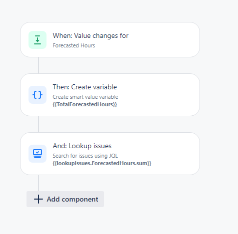

I need help with an automation rule. I have two type of forms that each has Forecasted Hours as a field. I created a new field called Total Forecasted Hours for each as well.  I am trying to set up the rule so for each issue submitted, it sums all the Forecasted Hours and shows it in the Total Forecasted Hours field. Here is the screenshot of what i have but is not working.Forecasted hours.PNG

I see the use of Lookup Issues and at a glance it doesn't look right because it should be driven by JQL.  The smart value you have in there would likely be used on an Edit Issue action.

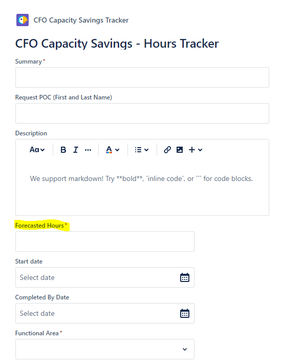

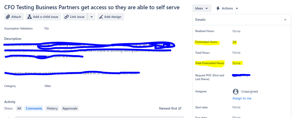

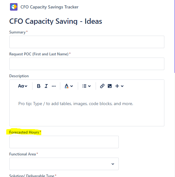

Thank you for taking the time to review my question. My goal is to sum up hours from the field called "Forecasted Hours" and show the total sum in the field called "Total Forecasted Hours" in all issues but by form (Sorry if i am not using the correct terminology).
1. I have two forms created in Jira Work Management. One called Ideas and the other Hours. (Picture attached). They each have the field "Forecasted Hours". Everytime a user submits a form for either one, they have to fill out that field.
2. I am trying to create a rule where it adds all the Forecasted hours for each form and shows the total in another field. (Third picture - This is an issue i open where you can see a field i created called "Total Forecasted Hours".

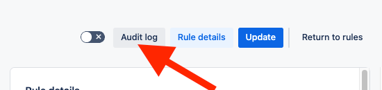

Can you show us what is in the Audit Log for the rule?
If the rule has executed you should see an entry there with a status other than CONFIG CHANGE. Click on the "Show More" link next to the most recent entry that is newer than the last entry with a CONFIG CHANGE status, and share the details with us.

How is the rule not working? What do you expect it to do? Do you expect it to update a field in the newly created issue? Based on what you have shown us there is no step to update any issues.
I think you are also using the Lookup Issues action incorrectly. Lookup Issues requires that you enter a JQL to use to select issues that you want to use in your rule. The results of the Lookup Issues action are stored in the {{lookupIssues}} smart value. It appears that you plugged in a smart value in that action where you needed to specify a JQL.
