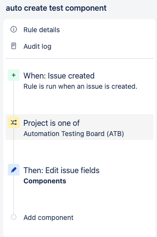

Would somebody be able to explain exactly what I would need to change with my automation in order to achieve this? So fat, its a pretty basic build:
  • When issue created --> and project = Aud --> Then edit issue (component) (Component A)

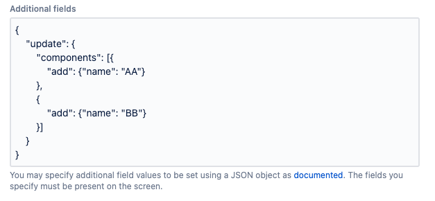

Tina Leszkiewicz
March 8, 2023
For those looking for an answer to my second question (which is down below) about how to add 2 components, I have the correct JSON code format, courtesy of Atlassian Support chat.

@Bill Sheboy Another quick question for you (if you don't mind)...
How would you format the JSON if you want to add an additional second component?
I'm realizing that my rule would run better with if/else conditions, so I'm trying to set up my "Else" to add two components if the field is empty. But all of my attempts have yielded some sort of "parsing error" so clearly I'm missing something
