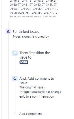

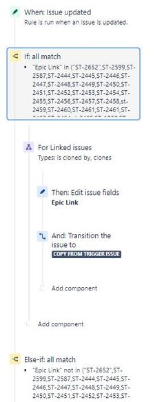

Hello All,
I am having an issue with an automation rule. The main problem that I want to solve is that due to the limit of runs for a rule in the global automation I have to limit the role and copy it on each project. The problem is that the rule is supposed to update a linked issue in another project but because of the single-project limitation, it doesn't recognize the issues that are linked in other projects.
I did test the rule on the global automation and it worked fine but because the rule runs every time there is an update that causes the rule limit to be reached.
