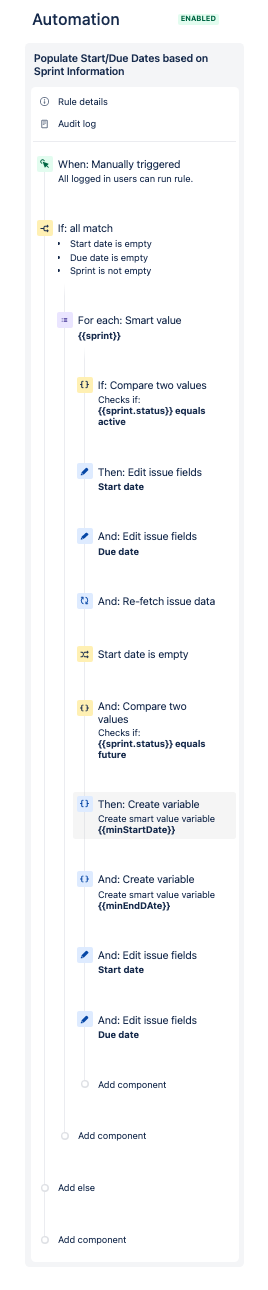

Here is my attempt to build a rule:
sprint is defined as follows:
  • Smart Value. {{customfield_10020}}
  • Variable name: sprint
minStartDate is defined as follows:
  • Smart Value: {{#customfield_10020}}{{ if(equals(status, "future")) }}{{/}}.startDate.split(",").min
I got some ideas, on similar situation. What I pretend with the above formula (but I am a beginner with automation) is:
  1. From the list of customfield_10020 which is the custom field where the Sprint information is stored in my Jira instance. I am using an if condition to filter the list by status equal to "future" only.
  2. For the filtered list, I am going to get the startDate and use split to find the minimum.
and similarly minEndDate is defined as follows:
  • Smart Value: {{#customfield_10020}}{{ if(equals(status, "future")) }}{{/}}.endDate.split(",").min

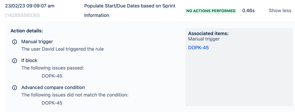

I tested the rule with an issue that doesn't have an active sprint assigned and only one future sprint. Here is the log result:
The advanced compare condition, doesn't match

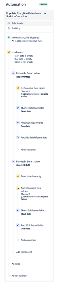

I had several errors or mistakes in my initial approach:
  • I used status, but the field is state.
  • I though the brach can have multiple conditions, but doesn't happen, so after re-fetch, the next condition: start date is empty is never reached, so I need to create a second branch. It looks to me inefficient, but it seems this is the way it works, unless there is another way to do it.
  • The condition to find the minimum start date and end date of the future sprints, I could not make it works. I generated an log entry to test it and it doesn't return the expected value, I tried several options and in most of them it returns empty string.
  • I realized, but I am not sure, that you can only assign an issue to one future sprint, therefore I don't need to deal with the min function, but anyway it should work for a single value, but as I said could not make it work.
Based on previous comments, this is the rule that works, but maybe there are better ways to do it.
where the start/due dates are assigned respectively as follows:
{{sprintInfo.startDate.jiraDate}}
{{sprintInfo.endDate.jiraDate}}

What does your testing show for the results of the above rule?  I am asking because I hypothesize some unpredictable results...
Branches on one-and-only-one thing (e.g., Current Issue, or Parent (Epic), etc.) get run in-line, and so the rule proceeds on the order of the steps you define, as if there was no branch.
However...branches on things which could have more than one value  (e.g., Advanced branch, JQL, sub-tasks, etc.) are run in parallel and asynchronously.  There is no guarantee when the branch will complete, up to the point of the end of the rule.
And so for your rule with two advanced branches, the branch items could run in any order, potentially overlapping in time.  Without seeing the source of your advanced branch information it is unclear to determine if the Start Date and Due Date fields could be repeatedly set/walked over in values.
A possible work-around for your use case would be to use a single advanced branch, with if/else structures inside to handle the different cases of the Sprints' state.

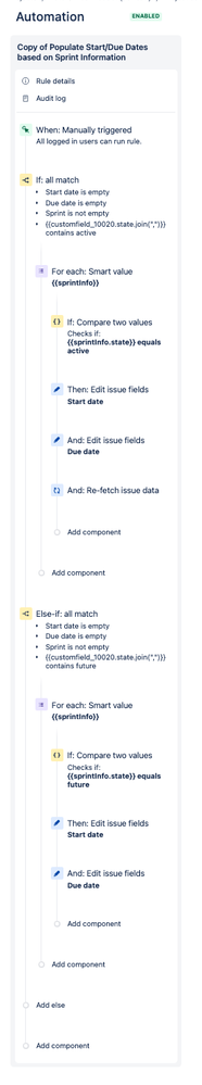

Thanks @Bill Sheboy it makes sense, in my case it worked, I trigger it manually with an issue that has just a single future sprint assigned. Initially I tried to have everything in an a single advanced branch, but it didn't work, because inside the Advance Branch you can add only add: New Action and New Condition, and the New Condition doesn't have an if-else block, so each condition you add runs one after the other. This is what I experienced. In my question I provided the screenshot with a single Advanced Branch, but it didn't work, since my issue has only one future sprint, the first comparison failed (no active sprint), then it didn't continue. Thanks for any help.

Gotcha; there was a "feature" which allowed creating if/else outside of a branch, and then dragging that inside, but I believe that may have been fixed.
The other work-around is to put the if/else conditions first, using smart value, list filtering to find matching sprints for the state.  Then have a branch inside of each if condition, based on state:
  • if/else condition
    • advanced compare condition: use smart value, list filtering to find sprints for "active:
    • branch: over those values
      • actions to update the dates accordingly
  • else-if
    • advanced compare condition: use smart value, list filtering to find sprints for "future:
I haven't tried that, although I suspect it will work.
Like • David Leal likes this
David Leal
February 24, 2023
Thanks @Bill Sheboy I guess I was able to follow you. I tested and it worked. For the advanced compared condition I obtained the list of states, then join it, and using the condition contains to find either active or future. That was my understanding from your recommendation, but may you had in mind something different or simpler.
Here is the rule:
Thanks!
Like • Bill Sheboy likes this
Bill Sheboy
February 25, 2023
Well done!
The variation I was suggesting was to prune the list of sprints (using list filtering) so the advance branches only walk what you want: active or future sprints.

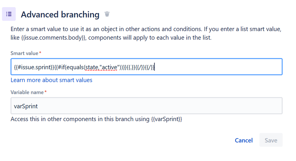

Bill Sheboy
February 25, 2023
Yes, you are quite close with your second expression.  Here is an example to filter the advanced branch to only cover the active sprint(s) for the current issue.
The text version of that is:
{{#issue.sprint}}{{#if(equals(state,"active"))}}{{.}}{{/}}{{/}}
David Leal
February 26, 2023
@Bill Sheboy it worked, thanks so much!!!
