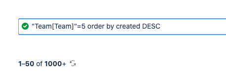

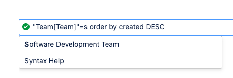

Trudy P Claspill
October 6, 2021
Go to the Search Issues screen.
Start entering a search for a value in the Team field.
After you select the matching team, the filter will automatically update to show the team ID.
Like # people like this
