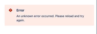

First of all, if I check here in the issue:
I see this weird ERROR:

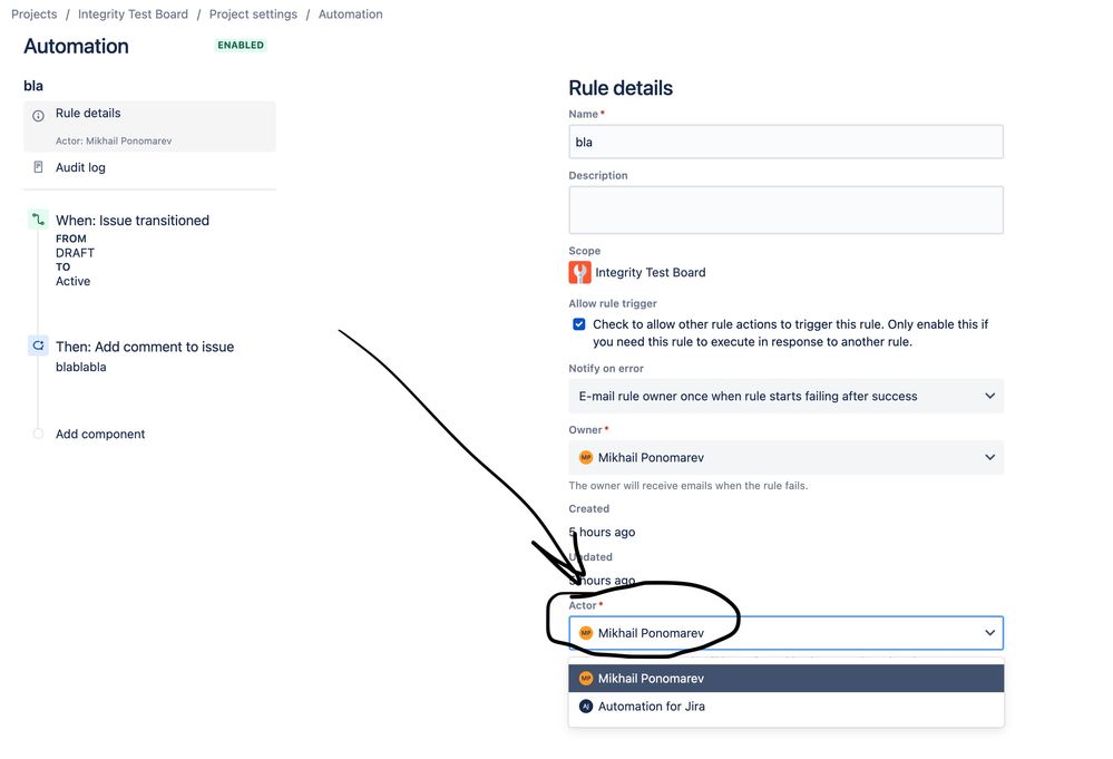

You may think that I also have to restrict issue to Automation for Jira. I don't think that's needed. In my Automation rule - I have changed Actor to myself! So I don't think "Actor" is a problem here....

Ok, so you'll need to show us the automation, the "restriction" and what it is doing.
Not helping… in my automation rules “actor” is me and I am the one to whom issues are restricted….
Automations respect the restrictions on issues, so check who the "Automation user" is - the account that runs the automation matters. You'll need to include them in the "restriction" (I'm not sure what you mean by that though - project visibility? Project permissions? Issue security? Workflow conditions?)
