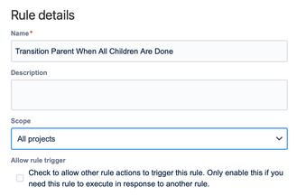

It's not a problem to run rules across multiple projects but you will need admin rights to make sure your rule isn't limited in scope to a single project. You set this in the automation global administration.

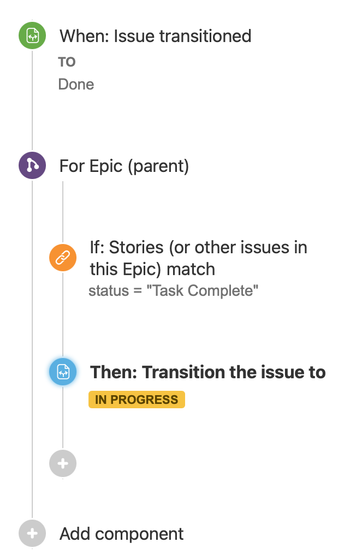

The rule will then run on ALL issues (or all issues in projects you include in scope) when transitioned to 'Done'.  It should look something like the below (with the status 'Admin Review' instead of In Progress per your spec)
