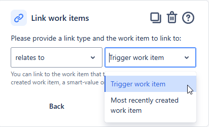

Hi,
I'm trying to create a link to an specific item within an automation in Jira cloud.
But in the rule builder, I can only select "Trigger work item" or "Most recently created work item".
How can I achieve to link to a certain item using the item key ("ABC-1234")?

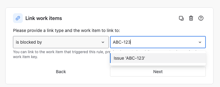

Hello @Sönke Bostelmann
If you want to link to an explicit issue simply type the issue key into the field.
Then click in the area where it shows Issue 'ABC-123' to insert that value into the field.
Sönke Bostelmann
June 19, 2025
Thanks, that was the hint I needed.
I did not notice that I have to click on the area below the input.
Like Trudy P Claspill likes this
