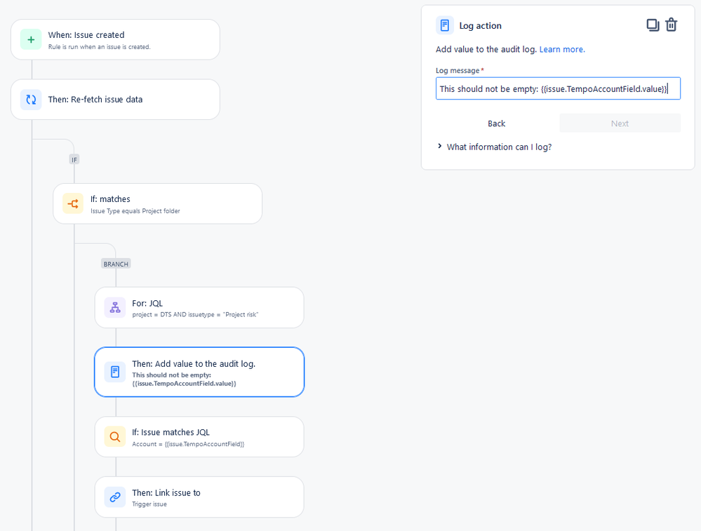

Please try writing this to the audit log, just before your statement using the JQL:
This should not be empty: {{issue.TempoAccountField.value}}
Then test your rule and post an image of the audit log.
Once possible cause of this: there is a known symptom with the Issue Created trigger that it can fire so quickly the issue data is not yet available for the rule to use.  (i.e., a race-track error)  The result is the rule steps do not work as expected / in a predictable manner.
The work-around for this is to always add the Re-fetch Issue Action immediately after the Issue Created trigger.  This will reload the data before the rule proceeds.  Please try that after the above test.

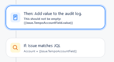

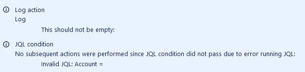

Estelle Decanis
December 21, 2023

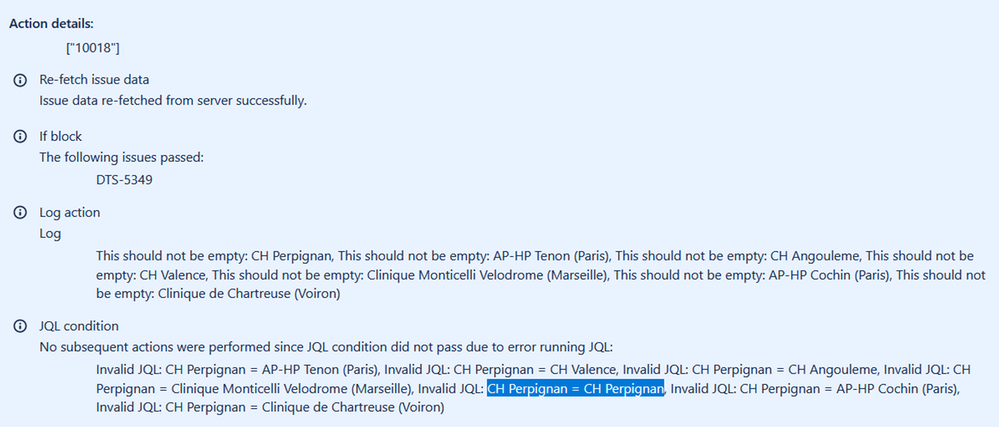

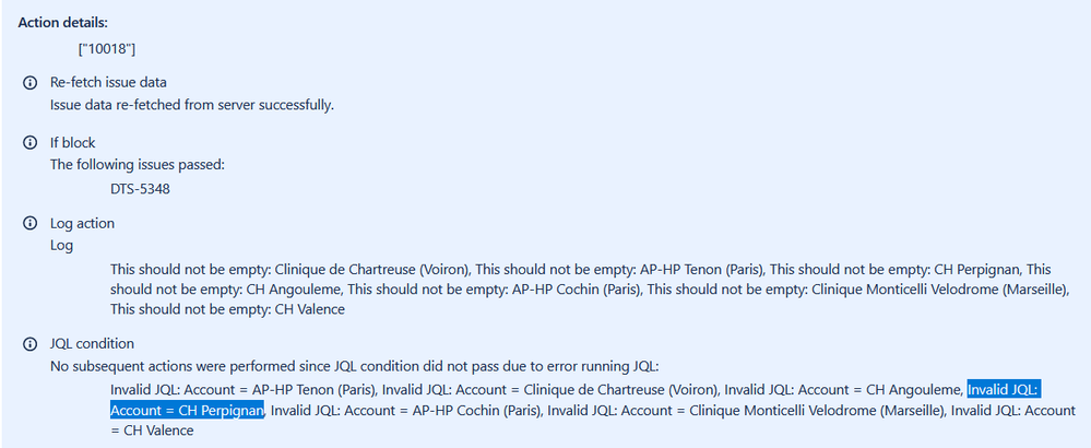

if it's correct
it doesn't work

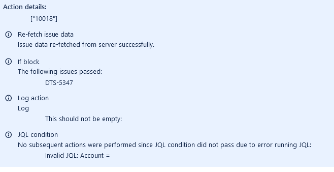

I try with Re-fetch :
@Bill SheboyI must have made a mistake using your instructions
Like Bill Sheboy likes this
Bill Sheboy
December 21, 2023
Thanks; that rules out a couple of possible causes.  Let's now check if the Tempo documentation is correct...

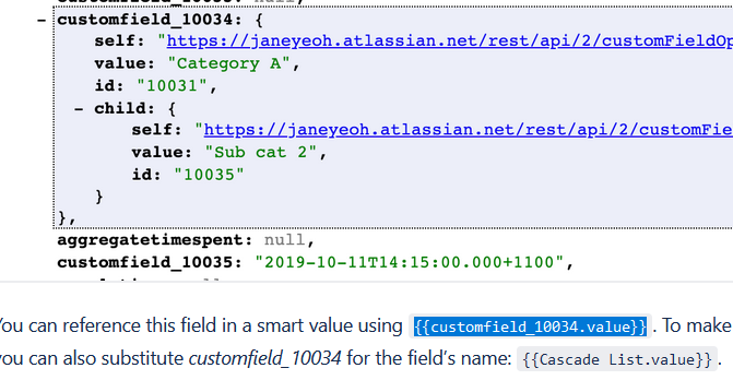

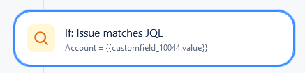

I fund this :

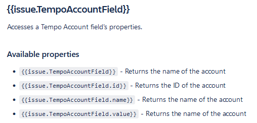

in the Support/Atlassian documentation there was this example:
I set it up with the id of my field
There's change :)
it's the name of the center looking for.
It found it, but apparently it's invalid. And the action of the automation doesn't work

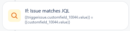

Estelle Decanis
December 21, 2023
I change the condition :
The center of the trigger issue is identical to that of an existing ticket (this is what I was looking for) :
But it's still marked Invalid JQL :/

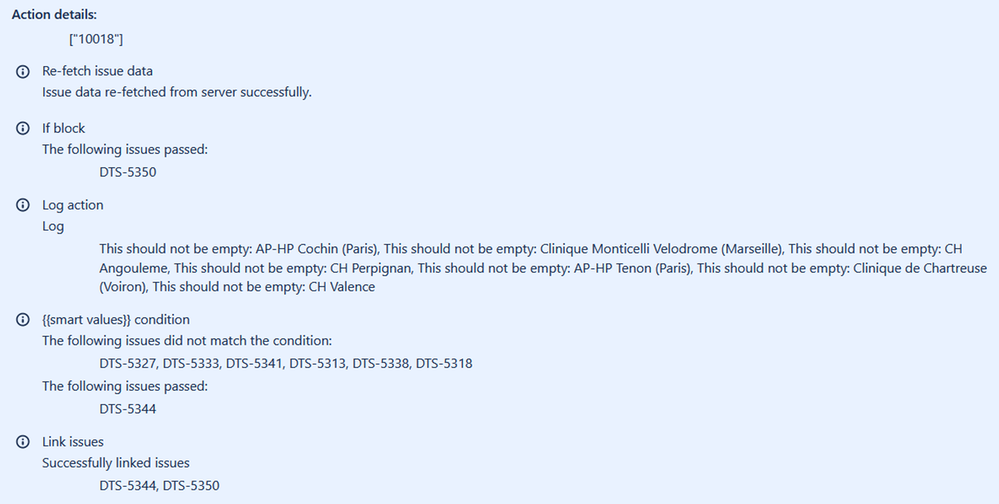

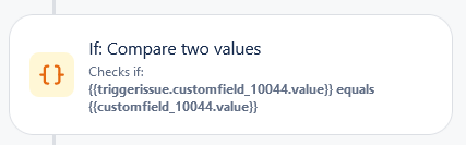

Estelle Decanis
December 21, 2023
it's a smart value so the condition shouldn't be "jql" but "smart value" :

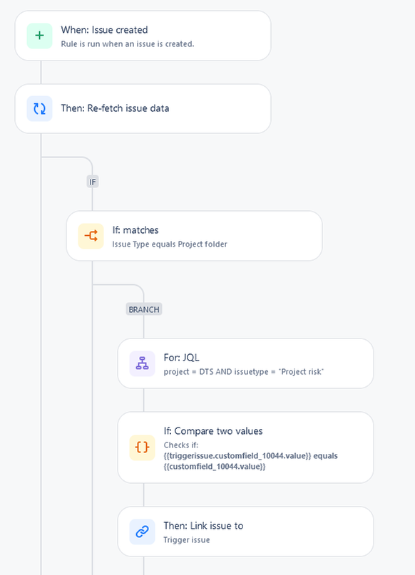

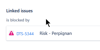

the action could be done (= link issues) :
Here's the automation :
Thank you so much @Bill Sheboy
Bill Sheboy
December 21, 2023
Well done!
And I see why your JQL condition failed: there are embedded spaces (and other characters) in the values.  The fix for that would be to wrap the smart value in quotation marks for the JQL, like this:
Account = "{{issue.customfield_10044.value}}"
Like Estelle Decanis likes this
