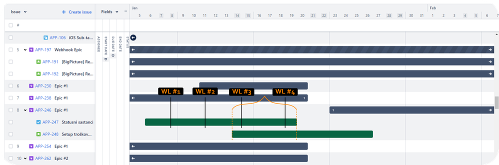

We have stumbled upon a specific use case. Let's say there are two issues - APP-247 and APP-248 and User A is assigned to issue APP-248 (and this issue has Start date set). While working on APP-248, the user has also logged some work on APP-247. I/the client would like to get a report displaying only those worklogs from APP-247 that have started after the start date of APP-248 (see image below - in this example, we would only like to write down worklogs "WL #3" and "WL #4"). The 'report' could actually only be text field on APP-248 issue that contains this information.

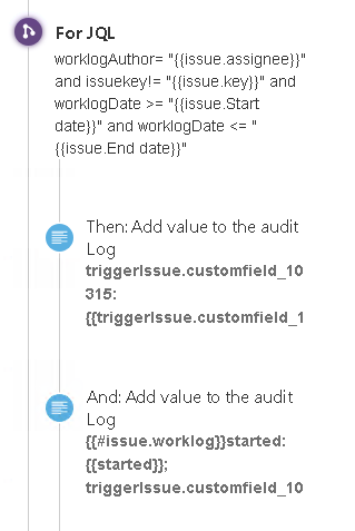

We've started to build up an automation for this and this is what we have so far...
First we have a branch that finds all issues where the person who was assigned to a trigger issue also logged time after the "Start date" of an trigger issue (this works fine 👌).
Next, for each filtered issue, we go through the worklogs by using {{#issue.worklog}} smart value. The problem occurs when we try to fetch {{triggerIssue.Start date}} smart value within this iteration - it seems that system cannot 'handle' that - meaning you can only get values from iterated worklog (e.g., author, started date...) but nothing out of that scope.

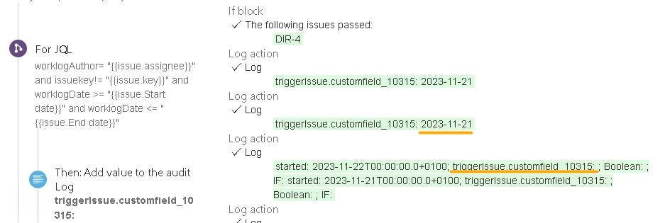

I've tried logging the following phrase:
{{#issue.worklog}}started: {{started}}; triggerIssue.Start date: {{triggerIssue.Start date}}; IF: {{if(started.isAfter(triggerIssue.Start date), "true")}}{{/}}
but as you can see in the screenshot below, outside the iteration smart value properly shows trigger issue date, while inside the iteration it does not.2023-11-23_17-53-25.png
