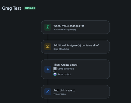

The goal:  When we add a specific stakeholder in the 'additional assignee(s)' field in the origin epic, it should create a new epic in a different project with all of the same information pulling through since the fields all match and then the two epics should be linked together.

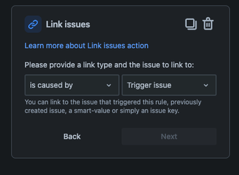

The Issue: the rule shows as successful when the identified stakeholder is added to the additional assignee(s) field and the new epic in the other project is successfully created, but the two are not linked together. It appears the hold up is in the "And: Link to" section of the automation. It is set to: 'is caused by' 'trigger issue'. We've tested using the other option: 'most recently created issue' and that works just fine but would open up room for error within our processes. It needs to be trigger issue to work properly. When the rule is run, the new epic is created perfectly but there is no link between them.

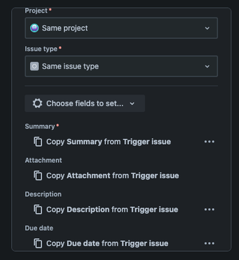

First, you describe wanting to create the new issue in a different project, but the rule action shows creating in the same project.  Is that an error?
If you did want to create the issue in a different project...What is the scope of your rule: project, global, or multiple-project?
All three scopes can create (or clone) issues into other projects.  However project-scope rules cannot view or update issues in other projects: only global or multiple-project rules can do that.
To correct that, your rule's  will need to be modified by your Jira Site Admin.
Finally, the way your rule is structured, the link action is running against the trigger issue...and then it tries to link to the trigger issue (i.e., the same one).  Instead, change the linking to the "most recently created issue".

Thanks, Bill! I ran tests with the different project which resulted the same way, so had moved testing to the original project to keep from clogging up their boards with all my test cases. Will keep the scoping in mind, but for what I have access to I can see and manage what I need to since I have admin access across projects.
Re: linking, I had avoided using 'most recently created issue' because I thought it would create possibility for the wrong issue to get linked as we have a form integrated to our project that gets a high volume of submissions which are turned into epics. My understanding, which may be incorrect given your response, was that the new issue may then link to whichever issue is newest which could be something unrelated to the issue we want to connect with (the trigger issue).
Through testing, it appears that using 'most recently created issue' solves our problem, so I appreciate that validation and your assistance!

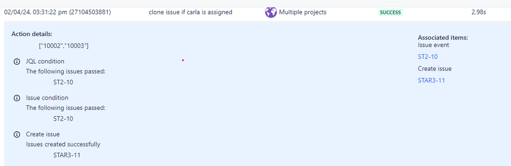

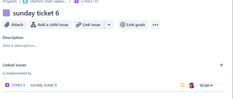

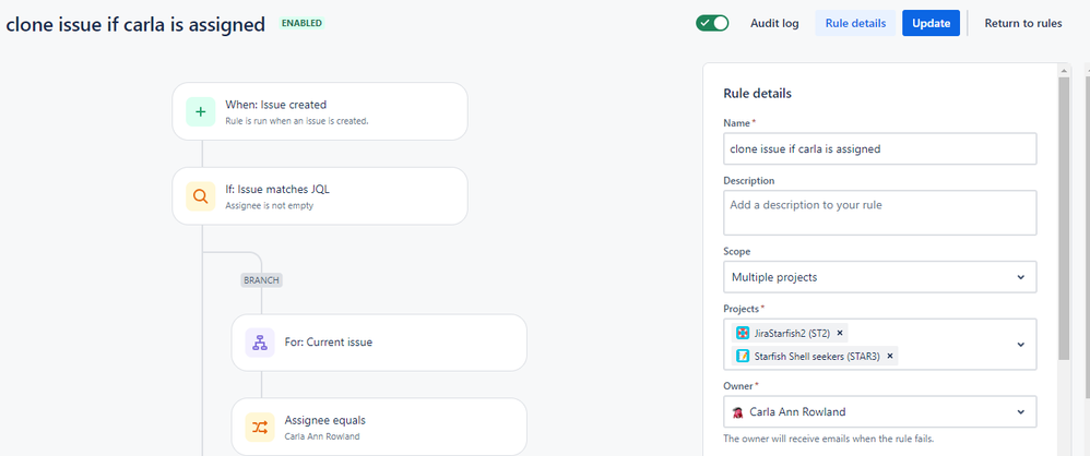

@Greg Mihailides @Bill Sheboy  I created a rule that clones the ticket if it is assigned to when created.
the snapshots overlap a little. It works and both trigger and new ticket are epics.image.png

One adjustment you may want to consider:
The issue created trigger can fire so quickly that some of the issue data may not yet be available to the rule...potentially leading to the condition not working as you expect.  The work-around for this is to always add the Re-fetch Issue action immediately after the Issue Created trigger when it is used.  That will slow the rule a bit, reloading the issue data before proceeding.

Thanks for weighing in. It doesn't seem to allow me to add in smart value or issue key in the link issues. Only option is the drop down of trigger issue or most recently created issue despite the explanation below the dropdown.
