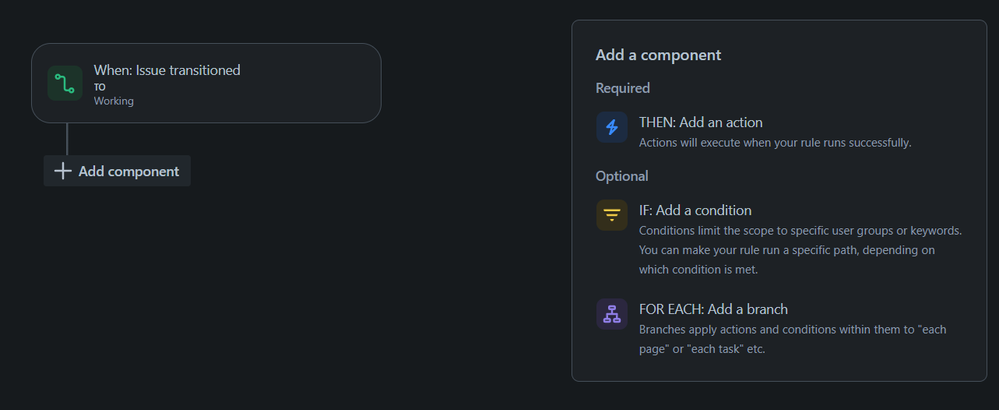

Eli Cady
July 10, 2024

So, the next step is to find out if there are other issues assigned to the same person that are already in the Working status, and if there are, change their status to Work Paused.

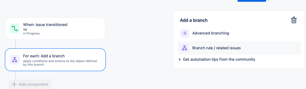

I would suggest the FOR EACH: Add a branch option. When you select that you get these options:

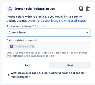

Select Branch rule / related issues. Then you get this:

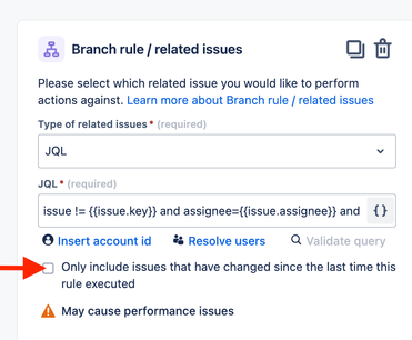

In the Type of related issues pull down select JQL. You can then formulate a JQL statement to look for any other issues assigned to the same person as the triggering issue, that are also in the Working status. (I'm using In Progress as the status in my example.) Make sure that you uncheck the box pointed at by the red arrow.
The full JQL in my example is
issue != {{issue.key}} and assignee={{issue.assignee}} and status="In Progress"

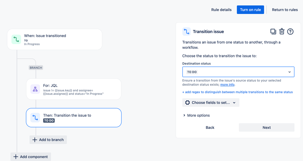

Then, within the branch, you add the Transition Issue action to transition those issues you found to Work Paused. (In my example I'm using "To Do".)
