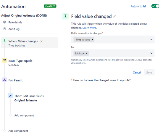

And here is the screen of the rule:

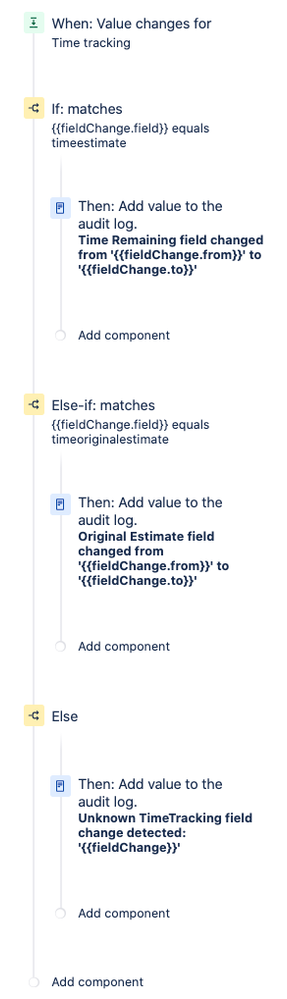

It took some digging in the docs and experimentation, but I created the following test rule. The conditionals and smart value usage should help you with what you need to do.
This rule uses the same trigger you're using. The conditionals differentiate which field changed (and also detects an unexpected trigger). The logs illustrate how to access the "before" and "after" values for each change.
Note that the numeric values are accessed in this rule (e.g. fieldChange.from). If you want string versions, use fieldChange.fromString instead.
Note also the conditionals ARE CASE SENSITIVE. So checking for "timeEstimate" will NOT work -- the first conditional shown here uses "timeestimate".
Hope this helps!

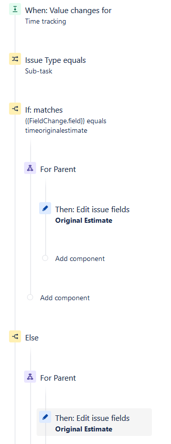

{{#=}}({{issue.fields.timetracking.originalEstimateSeconds}} - {{triggerIssue.timetracking.originalEstimateSeconds}} +{{FieldChange.from}}) / 60 {{/}}
Also, this formula and condition wont work on a newly added Sub-tasks (with estimate zero), so you need to add an Else condition with out match rule but with 1st formula.
Maybe its not that elegant, but It works =)

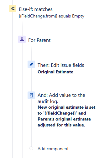

Small Update, ELSE need some adjustments otherwise it will keep editing Parent's original estimate every time you change Sub's remaining estimate or wont reserve budget on a first Sub's estimation.
