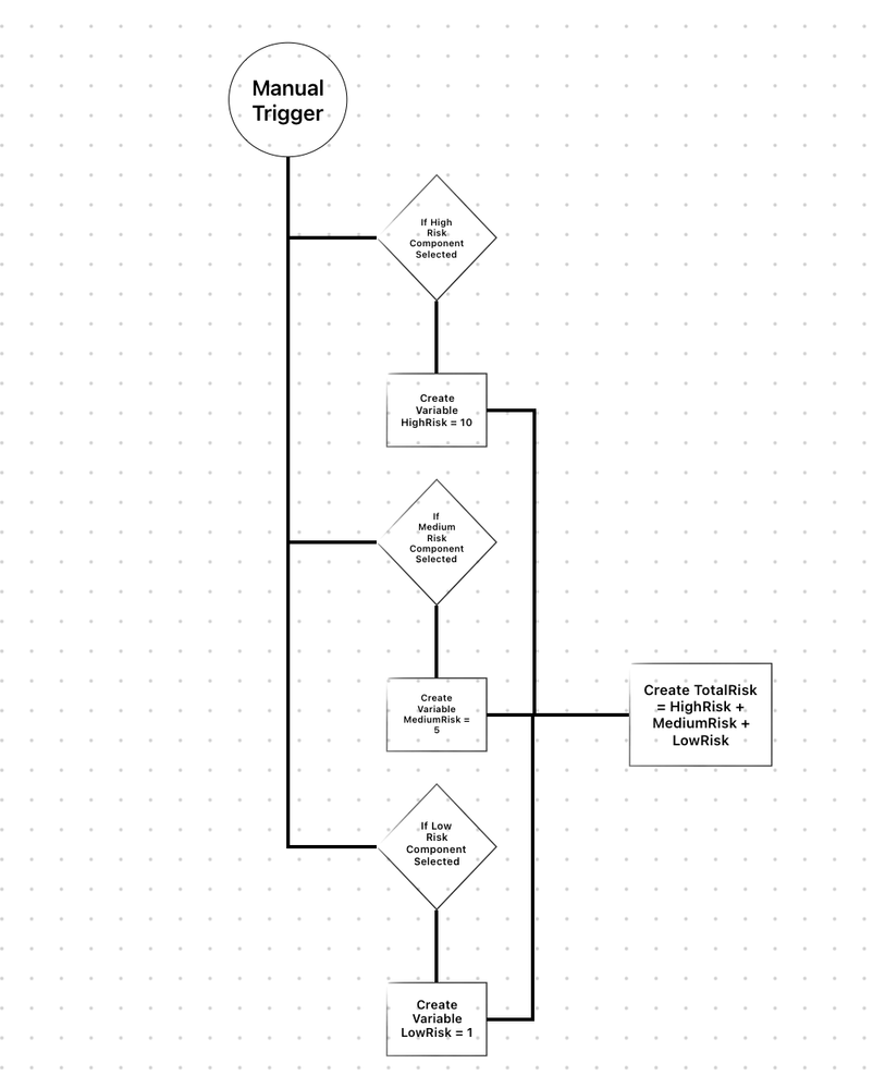

Hi guys, I am trying to create an automation that does the following -
Let's say there is 20 components held on the (Compass Components List) -
  • 10 of them are "High Risk" with a value of 10 points.
  • 5 of them are "Medium Risk" with a value of 5 points.
  • The remaining 5 are "Low Risk" with a value of 1 point.
I am trying to make a manual trigger automation that automatically calculates the total score of their risk based on the fact that no matter how many of those "Components" of a specific risk level are added, their value is only considered once.
So High Risk + High Risk + Medium Risk = 15 Points not 25.
So far, I've encountered a stumbling block in attempting to use an Automation to calculate this score -
If I use branching and set up an IF Condition saying if High Risk Component is selected, then create a variable called HighRiskScore with score 10. And then a second branch saying if Medium Risk Component is selected, then create a second variable with the score of 5. And ask them to output at every branch, I get a total value of 0. Meaning that when I then try to calculate the total score, I also get 0.
If I use If / Else conditions, I block out the possibility for it to advance down the chain of IFs by having the first condition met. And if I use just an IF condition followed by action, followed by a next IF, it skips all the points underneath the original IF.
Does anyone know what I can do in this situation? I've attached a crudely drawn diagram of how I want it to act below.

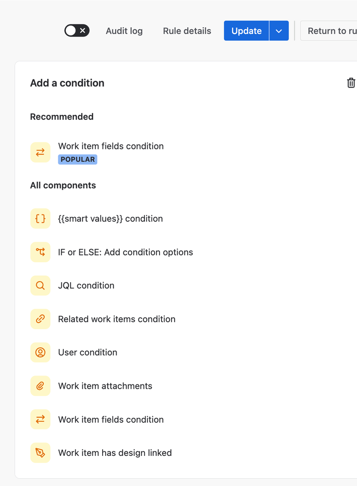

Tyler Cassar
May 15, 2025
Pardon my ignorance, how would I do that?
Alexander Hohmann
May 15, 2025
Underneath an existing IF condition, click on "ELSE". If you add at least one condition in the ELSE node, the 'ELSE' should turn into 'ELSE IF'. Otherwise it remains an unconditional 'ELSE'.
Tyler Cassar
May 15, 2025
Wouldn't that still lead to conditionals being missed?
  • IF Component is not Empty
    • Apply Action
  • IF ELSE Component is not Empty + Component = High Risk
    • Apply Action (Log Variable)
  • IF ELSE Component is not Empty + Component = Medium Risk
Wouldn't that mean if I had a High Risk + a Medium Risk, since there was an action taken on High Risk, it would just auto ignore the Medium Risk?
Or do I need to build it in a IF High Risk + Medium Risk + Low Risk, and all the combinations combined?
Alexander Hohmann
May 15, 2025
You certainly have a point there. And right now I cannot think of something more elegant than going through several combinations. You could use the 'contains' or 'contains none of' condition for the 'Components' field, or work with the 'IN' operator in JQL: 'component in (value 1, value 2, ...), or the NOT IN or the CONTAINS or the DOES NOT CONTAIN operators. Sorry. If I can think of something more elegant, I'll add it here.
Alexander Hohmann
May 15, 2025
One more idea: you could create three rules instead of one, and have the first one (the manually triggered one) do something that then triggers the other two (like modifying a field, perhaps a hidden one), each rule checking only for components of one type. But that will cost you three units off your rule count, which may be limited depending on you Jira license plan.
Like Tyler Cassar likes this
Tyler Cassar
May 15, 2025
I actually came to the same conclusion to get the final risk scoring funnily enough.
